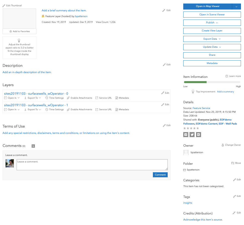

In particular, the output of the original join we did in November only included the two joined layers.
Original Join

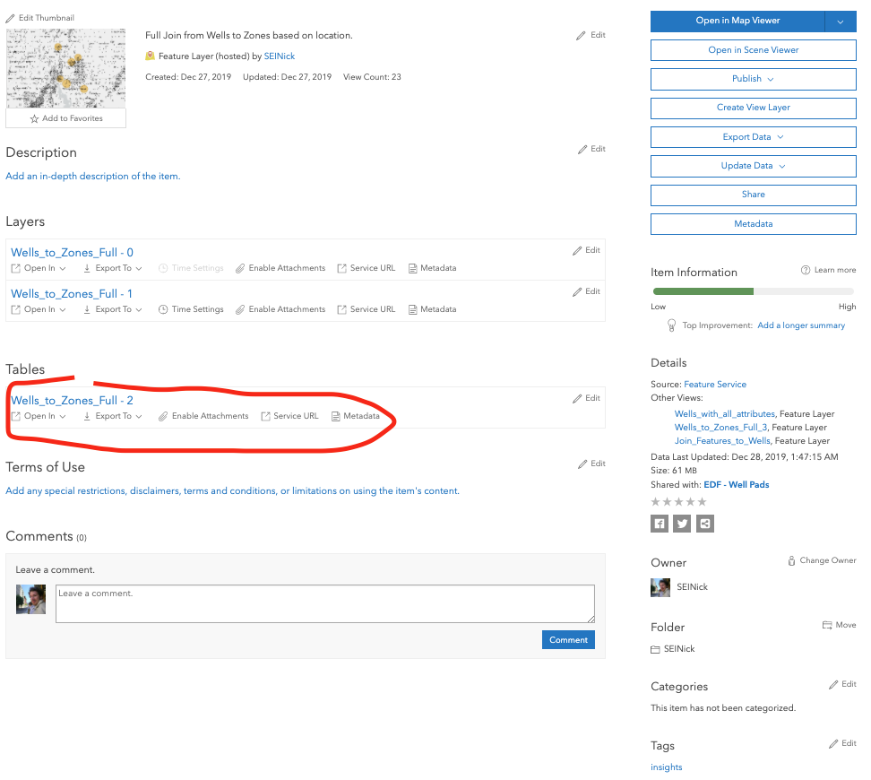

However, now we are trying to re-create the same sort of join with newer data, and finding that the output from Insights includes a third item ... a "table" of the join.
Newer Join from late December

It is expected that in some cases a 3rd table is created and is related to work done with many-to-many joins, where a bridge table is not provided.  The 3rd table you are seeing is, effectively, a bridge table that we now auto-generate in Insights to ensure we have effective and functioning many-to-many joins in all cases.

In our own explorations we've found that if we do a join (in Insights) from our big point layer (wells) to a polygon layer that we derive (say via buffering, or a tool such as the KML to polygon tool), then we are now getting that auto-generated "bridge" table. But if we create a brand new polygon hosted feature layer in AGO, and draw some polygons into.. then joining against it with the same join parameters does not generate a bridge table.
Is the bridge table generation based on thresholds? Or some other behind the scenes configuration in hosted feature layers?

Insights now generates the third table when it determines that a many-to-many (m2m) join is missing a bridge (aka junction) table.
When joining 2 tables on some field A, if A has duplicate values in both tables, then that's a m2m join. Typically in data modeling, a m2m relationship is constructed as a combination of a 1-m and m-1 relationships between 3 table. For example:
In cases where that bridge table is missing, Insights will create one and populate it with the right combination of matching keys based on the join type (full, left, inner, right). Hence, the 3rd table you see when you share the joined dataset.
This improvement should make m2m joins more stable overall, and allow you to use the result in further analysis.
