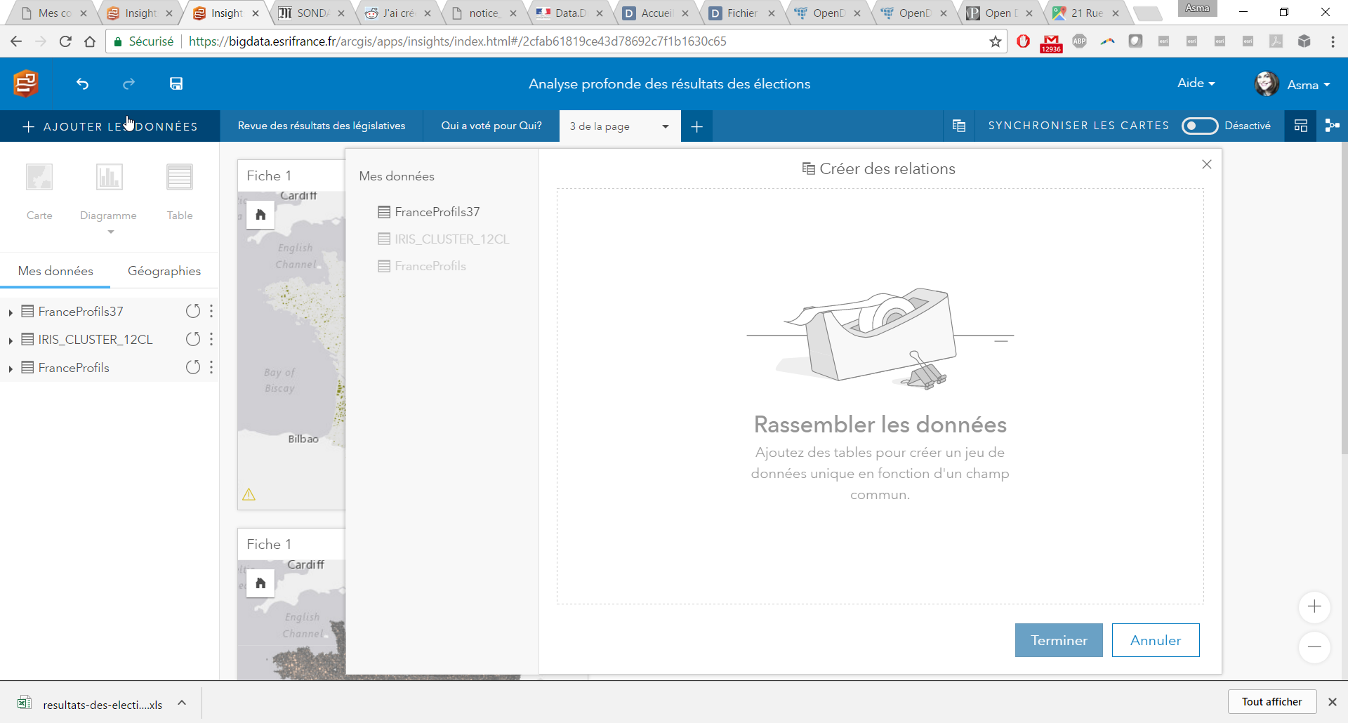

I want to create a relationship between 2 dataset.
One of my dataset is a feature service coming from ArcGIS Online. I registred the url of service with credentials, i can display it in insights but cannot do any relationship with this feature service.
Please, i need your help
The data is grayscaled.
Thanks

Currently you cannot include a layer from ArcGIS Online in a relationship.

HeikoHeijenga
Defining relationships between datasets is possible when:
Insights on ArcGIS Enterprise:
  1. Datasets are all originating from Hosted Feature Layers (stored in ArcGIS Relational Data Store) or added to Insights by importing an Excel/CSV file
  2. Datasets are all originating from same database connection
Insights on ArcGIS Online:
  1. Datasets are all originating from Hosted Feature Layers in the same organization or added to Insights by importing an Excel/CSV file
