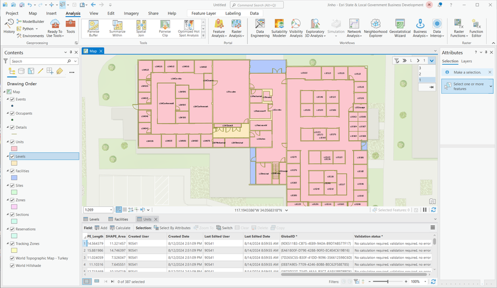

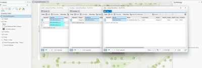

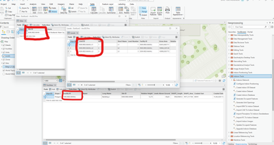

hi @Jinho_Kang
I am not sure if there is a problem with the SITE_ID, FACILITY_ID and LEVEL_ID area schemas. It seems to be fine. I do not know how the level id was deleted from the floor schema or why it was not there.
emreaktas1
hi @Jinho_Kang
Checking the field schema names SITE_ID, FACILITY_ID and LEVEL_ID is like this. I don't think there is an error here.
Jinho_Kang
Hi @emreaktas1 .
Thank you for sharing additional screenshots.
Can you zip the entire pro project folder files (that includes the geodatabase and aprx files) and send it to me?  (jkang@esri.com)
Also, it would be helpful if you could share which version of Pro and Indoor extension tier (Indoors Maps or Indoors Pro) you are using in the email.
Thank you.

Jinho_Kang
Hi @emreaktas1
I checked and downloaded the zipped file send by @İbrahimEnesSağlam
I opened the "Map.mapx" and;
1. I had no problem reading/configuring the Levels for the floor.
2. Rest of the data (Units, Details) worked with the floor-aware widget
3. I did notice duplicated indoor features within your data
I'm not sure what's preventing your ArcGIS Pro from reading and recognizing the floor-aware features; the schemas and values are all there.
The other methods I can recommend you to try are;
1. Completely delete/remove ArcGIS Pro's cache
2. Re-start the ArcGIS Pro (or maybe even reboot the PC)
3. Start and re-do from the new APRX/Project and folder
If the above methods fails, it most likely be an Esri tech support ticket.

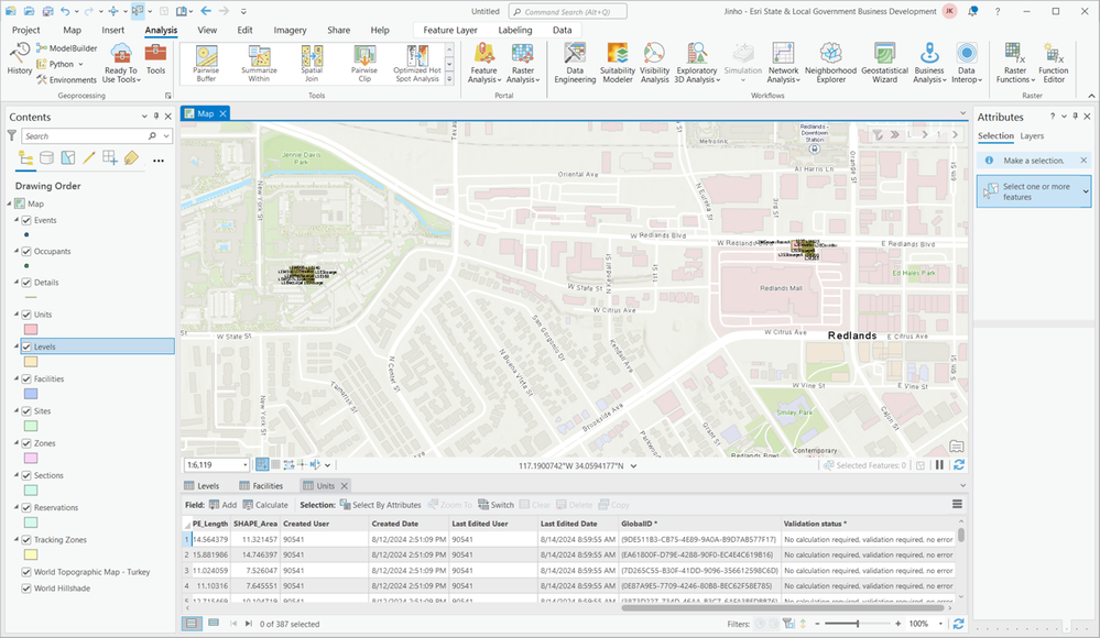

emreaktas1
I used mport CAD To Indoor Dataset (Indoors) tool and it transferred my CAD data to Indoor without any error. But in Indoor Layers section; Sites, Facilities, Floor section is empty and the floor filter is not activated. I wonder where I made a mistake.
