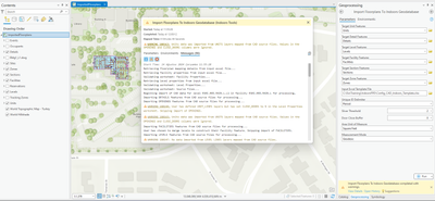

emreaktas1
hi
https://www.esri.com/training/catalog/5ecd6ae0dbabbe0afc9feb81/arcgis-indoors-loading-floor-plan-
I successfully completed the course and transferred the CAD data to the indoor layer, but the filter layer is not appearing.
Can you help me?
I am new to the indoor tool
Jinho_Kang
Hi @emreaktas1
Could you share screenshots of any GP tool errors, floor-aware widget setup, or the Pro's Map with how you set up the floor filter?

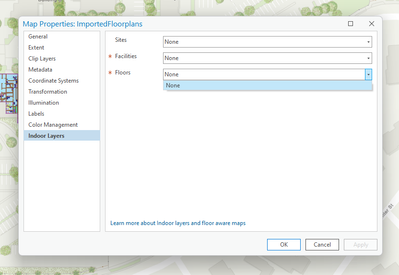

emreaktas1
hi @Jinho_Kang
Jinho_Kang
Hi @emreaktas1
Did you modify/delete the LEVEL_ID schema field by chance?
That's the most likely reason why the floor widget cannot detect the proper floor layer.
Please check if the indoor feature classes have intact SITE_ID, FACILITY_ID, and LEVEL_ID field schema names.
