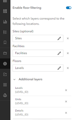

Hi @GauravJobanputra  - Thanks for the tips: I have tried it 10 times now following those instructions, and I still get the same problem:
I am using ArcGIS Pro 3.3.1, and "Create Indoors Dataset", and then following the instructions at the link above.
One inconsistency in the instructions is that step 13 says "Leave the Enable Sync checkbox unchecked." but I can't "leave it unchecked" because it is checked, presumable because of step 7.   I have tried checking it and unchecking it in ArcGIS Online and get the same problem.
Do you think my floor filtering settings in the web map look right?
