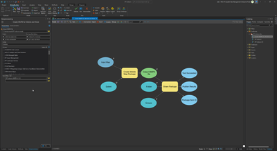

The 3.1.1 update does not seem to resolve issues when using the Create Mobile Map Package gp tool.  Here's a screenshot of the model I've been using for about a year now w/o issue:

Here's the Python call to run the model with inputs in the screencast above:
arcpy.ImportToolbox(r"C:\temp\sdm-services\IPF Indoors\IPF Indoors.tbx")
arcpy.IPFIndoors.CreateMmpkAndShare(
    Output_MMPK_file=r"C:\temp\mmpk\IPF Indoors v12.mmpk",
    Extent='-9406147.94364015 5271099.64778317 -9405881.40931504 5271276.60746578 PROJCS["WGS_1984_Web_Mercator_Auxiliary_Sphere",GEOGCS["GCS_WGS_1984",DATUM["D_WGS_1984",SPHEROID["WGS_1984",6378137.0,298.257223563]],PRIMEM["Greenwich",0.0],UNIT["Degree",0.0174532925199433]],PROJECTION["Mercator_Auxiliary_Sphere"],PARAMETER["False_Easting",0.0],PARAMETER["False_Northing",0.0],PARAMETER["Central_Meridian",0.0],PARAMETER["Standard_Parallel_1",0.0],PARAMETER["Auxiliary_Sphere_Type",0.0],UNIT["Meter",1.0]],VERTCS["WGS_1984",DATUM["D_WGS_1984",SPHEROID["WGS_1984",6378137.0,298.257223563]],PARAMETER["Vertical_Shift",0.0],PARAMETER["Direction",1.0],UNIT["Meter",1.0]]',
    Folder="Indoors",
    Groups="'Esri support';'Campus Infrastructure';'IPF Training Team';.SDM-Managed-Content",
    Input_Map="'IPF Indoors MMPK v1.2.0'"

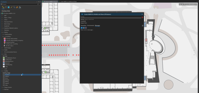

Here's a screenshot including the table of contents.  This map was shared successfully with the Create Mobile Map Package ribbon tool using the entire campus extent as reported earlier.

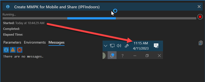

Jade_Freeman
Here's a screenshot after about a half-hour of running
Still nothing in output directory...

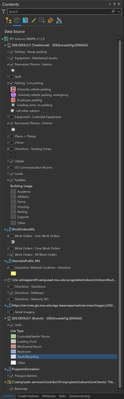

Screenshot of the datasources
(same map I was able to share successfully earlier using the ribbon tool)
