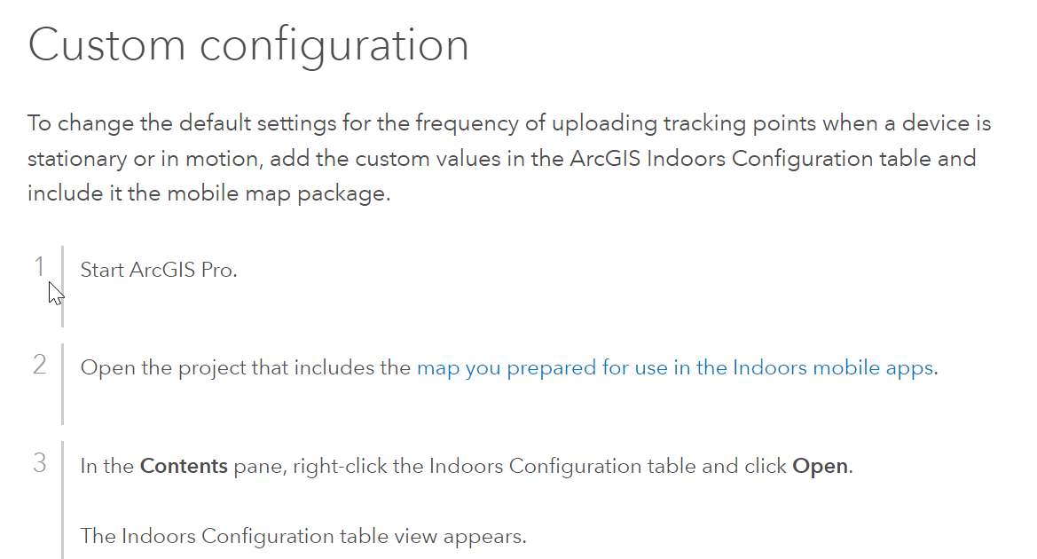

Meanwhile, the following documentation URL contains an explicit reference to the Indoors Configuration table:
https://doc.arcgis.com/en/indoors/mobile/ios/configure-device-tracking.htm

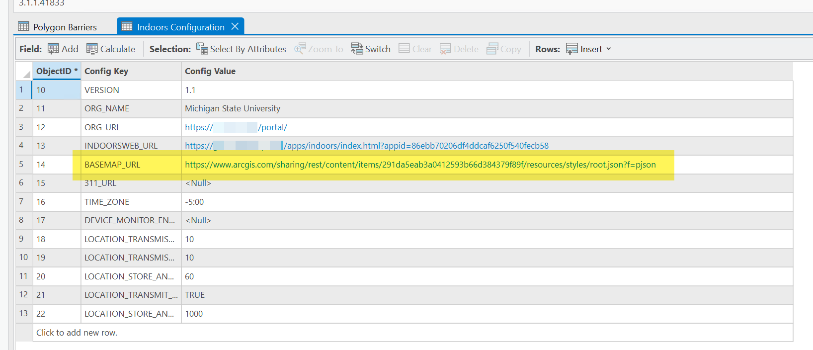

While I'm not expressly concerned with setting location tracking options, I did notice that when publishing an MMPK that does not include the Indoors Configuration table, the native mobile app will use a seemingly arbitrary base map when zoomed out past the extent of the vector tile base map included in the map.  If I include our Indoors configuration table, the native app will use the base map specified in the Indoors Configuration table:

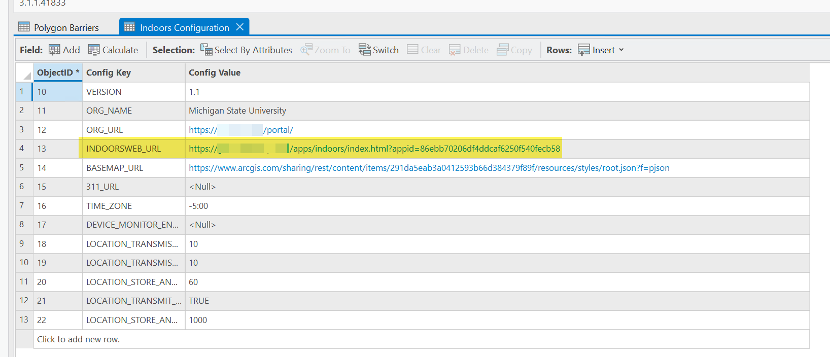

The other setting from the Indoors configuration table I'm curious about is the INDOORSWEB_URL:
Does this have any bearing on sharing url's sent from the mobile app?  What if the intended recipient is a web user, how would you configure this using the most recent documentation?

For Basemap: In previous releases, Indoors apps would default to the World Topographic basemap if no basemap was defined in the IndoorsConfig table. Starting ArcGIS Pro 2.9, when the Share Mobile Map Package and Create Mobile Map Package tools gained the 'Reference Online Content' checkbox, the Indoors apps honor which ever basemap you have in your Table of Contents in ArcGIS Pro. If it is not from the Basemap Gallery and a custom basemap then just make sure it is shared with the users of Indoors mobile.
Indoors Web URL andCustom Location Sharing settings: If needed, still requires to be defined in the IndoorsConfig table
