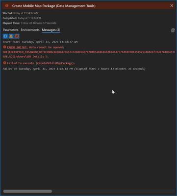

Thanks @GauravJobanputra!  GIS Professional user type, named user license.  This may help, after nearly two hours, the Create Mobile Map Package job I started using the gp tool and simplified map, finally errored out:
The error message indicates the details layer datasource cannot be opened yet details are clearly visible in the map:
Our network firewall does drop inactive connections after some period of lack of activity but I think this would just be further indication that the gp tool is not querying the datasource at all.  Further, the details layers is included in the MMPK shared using the ribbon tool.

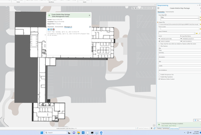

@GauravJobanputra Without a way to save a copy of our current project compatible with Pro 3.0, I was able to install ArcGIS Pro 3.04 on a clean workstation, create a new project and very simple map (Facilities, Levels, Units, Details - configured for floor aware) and was able to use the Create Mobile Map Package tool to create a MMPK in about 16s for one building.
As soon as I hit run, I immediately saw messages being output to the details window, whereas in 3.1, no messages are output at all.
