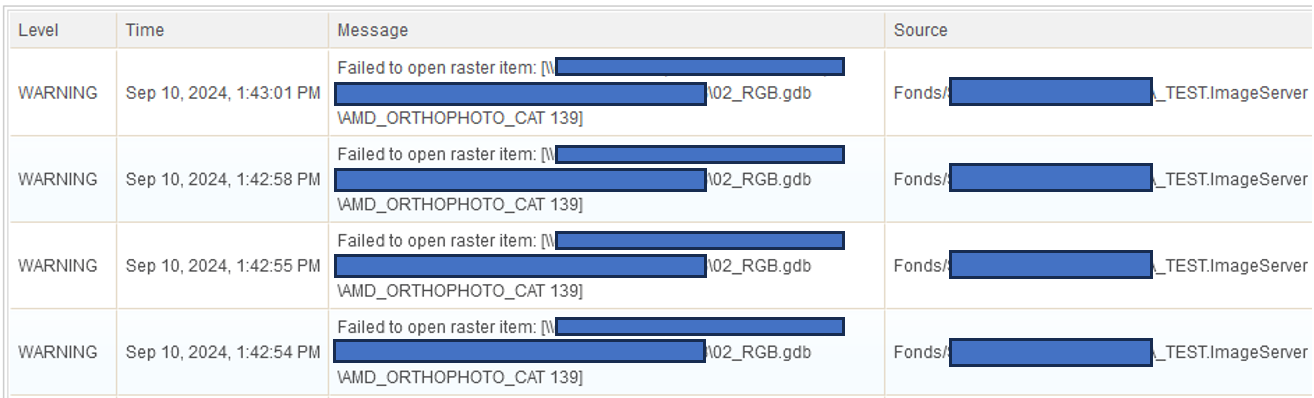

Mosaic dataset is successfully displayed but not the last mosaic dataset that I added and that should be visible by default. I checked ArcGIS Server manager log and I keep having the following error:
Failed to open raster item: [\\myserver\foo\02_RGB.gdb\AMD_ORTHOPHOTO_CAT 139]:
