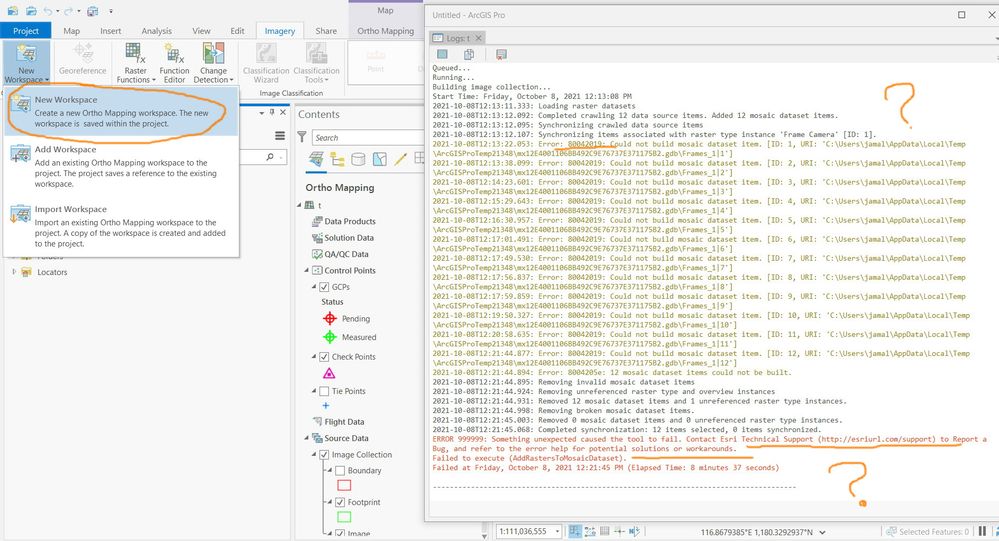

JamalNUMAN
Legendary Contributor
I got this error when creating Ortho Mapping

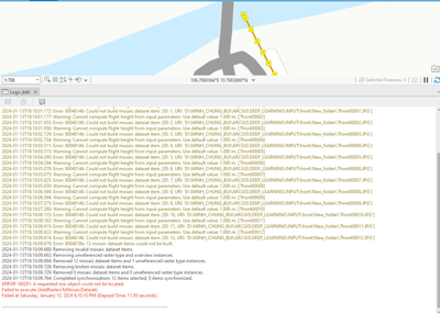

ChungBuiMinh
Hi Jamal,
I got the same problem. Did you have any solution for it?
Thank you for your help

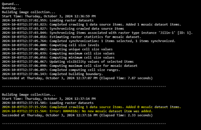

DanielaMoreno
New Contributor
También tengo el mismo problema,
Alguna solución, tal vez??
