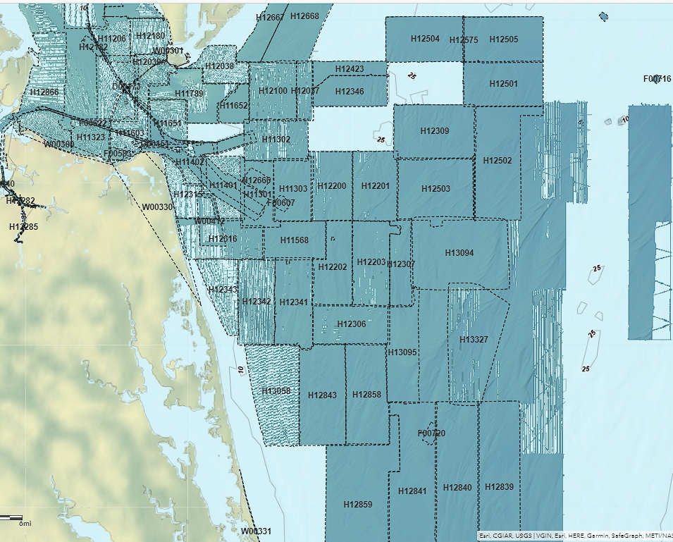

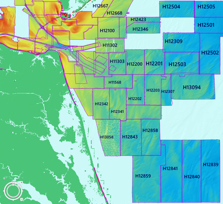

Here's a couple images how the bag bathymetry ColorHillshadeBAG processing template looked like before & after (whatever changes were implemented).
Old ColorHillshadeBAG Symbology.pngOld ColorHillshadeBAG Symbology.pngNew ColorHillshadeBAG Symbology.pngNew ColorHillshadeBAG Symbology.png
