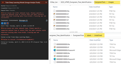

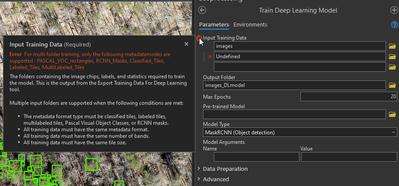

I'm having the same issue in Pro v3.2.2. There are tiffs in my \images folder and xml files in my \undefined\labels folder. I've tried running the tool with/without the labels folder. Without the labels folder, I get this error, making me think it needs the labels folder.
However, when I try to include my labels folder, I get the error below even though the exported training files used RCNN masks for the metadata format.

hello @GBacon sorry that I missed to see your message.
In the Train Deep Learning Model tool, you need to input the entire folder that is created by the Export Training Data For Deep Learning tool

GBacon
Thanks, Pavan. I'm all set now and I have a trained model.
