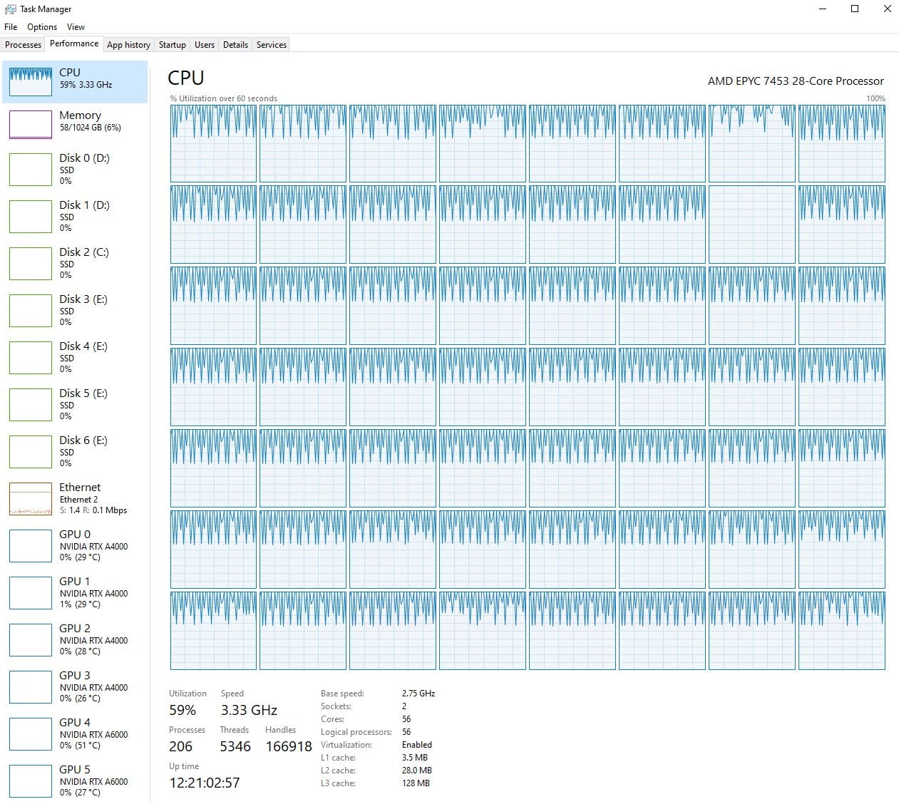

However, based on Task Manager display, the CPU is doing most of the work.  CPU_trainModel.JPG

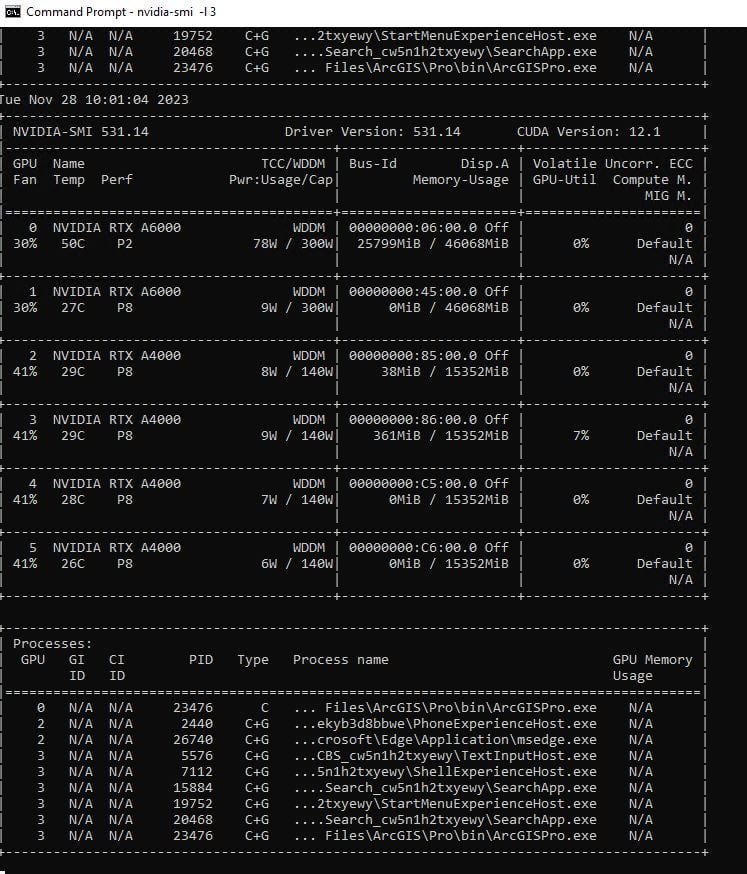

I also tried nvidia-smi to check the performance and it's also showing that the GPUs are practically not being used.

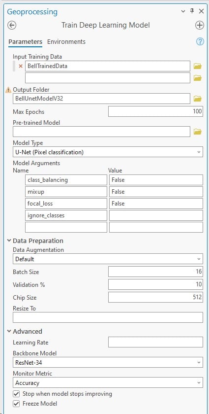

The following shows my parameter and environment settings:
