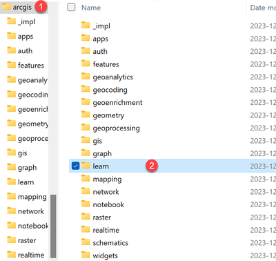

learn is in the arcgis module which is probably already installed on your computer in the base or cloned environment
"C:\... your install folder ...\bin\Python\envs\arcgispro-py3\Lib\site-packages\arcgis\learn"
