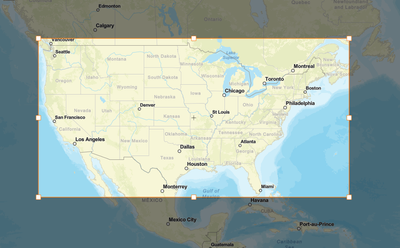

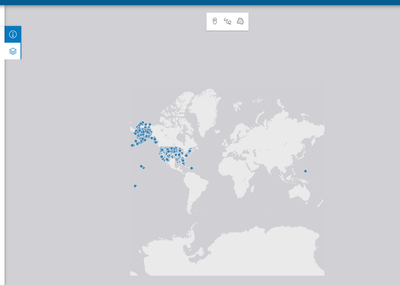

I'm still having trouble with this issue. My Public School Characteristics file displays the data at a global scale when I view it through Open Data.
But the extent is set to the contiguous US as seen in the screenshot below in ArcGIS Online.
