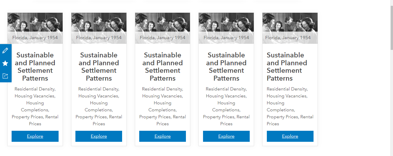

I am trying to add five cards to a row in Hub but am having through to center them across the page. I've used the out of the box set up that adds three by default. I have adjusted the html to display 5 in one line rather than 3 but am having trouble centering them. At the moment they are left aligned (see image below).
Could you help in getting them centered on the page?

Hub uses the Bootstrap 3 framework, which relies on a 12 column grid. Assuming you are using a single Text Card and each card is wrapped in the Bootstrap grid classes you have above, you may want to look at adding a col-md-offset-1 https://getbootstrap.com/docs/3.4/css/#grid-offsetting on your first card since you essentially have two extra columns leftover in your set of five cards.

Hi Klara, the offset suggestion worked perfectly.
Many thanks for your help.
