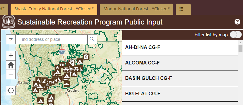

Hi there.  Want to share existing crowdsource polling apps within my Hub and am experiencing inconsistent behavior depending on how the app is exposed:
Application Card with Classic Story Map:  OK
App shared as a link within Text Card and opening in a new browser tab:  OK
App shared using an App or Iframe Card:  NOT OK

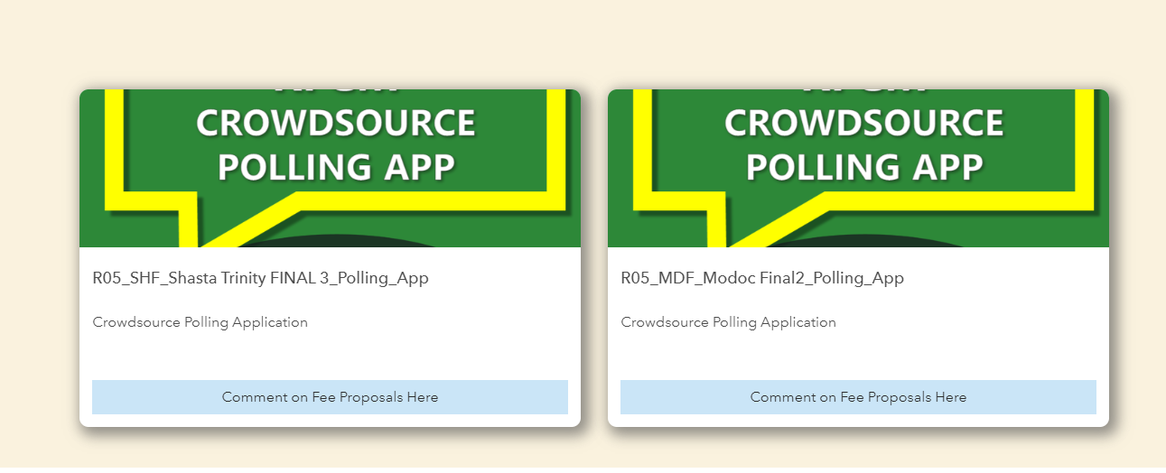

App shared using a Gallery Card:  NOT OK
Our preference is to use a Gallery Card or an App Card to share the apps:

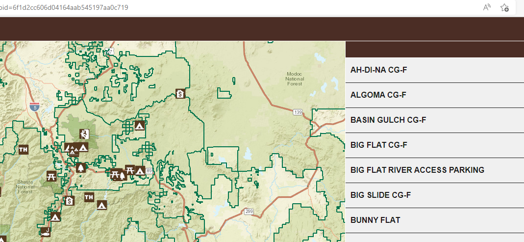

Therefore, it would be helpful to understand why in these "use cases" receive the following...
You are currently signed in as: 'xxx'. You do not have access to this resource: public proxy layer

Discovered the remedy.  Needed to access the Hub site anonymously.  Once the Hub site was shared with 'Everyone' was able to access the polling app using a public proxy layer via an app card or gallery card.
