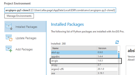

Alba_Page
Hi Manushi,
Sure... This is weird, if I check it on ArcGIS Pro the version installed is the 1.8.3 (and I don't have the chance to upload).
But if I check it on the command window it seems to be 1.8.4 version.
So I don't really know which one is working......
Thanks a lot!!
Alba
