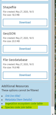

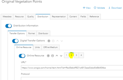

What I do is, if I have a related file I want to include, I add the URL to that item (the layer file on AGOL for instance) into the metadata of the main item under Distribution/Transfer Items/Online Resource, updating its Function to "Download" (down below in that tab).
Then it shows up as an Additional Resource in the download dialog.  Not super obvious, but at least associates it with that item and makes it available to the user.
Here is the item download URL if you want to see:  https://data-wi-dnr.opendata.arcgis.com/datasets/original-vegetation-points/explore?location=44.7684...
