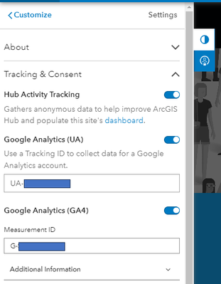

To add Google Analytics 4 to your Hub site, simply launch your site in edit mode, open the Customize side panel and navigate to Settings > Tracking & Consent, enable the Google Analytics (GA4) toggle, and paste in your measurement ID. Once the measurement ID is added, save and publish the site for the changes to take effect on your live site.

I can't speak as to why your setup is not working, but i'm pretty sure you add the Measurement ID in the 'Tracking and Consent' section like in your screen cap and not per page.

Good news, GA4 is now working with the Measurement ID. I believe the problem was that I saved the change, but didn't publish it. Lesson learned.
