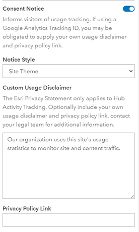

To add Google Analytics 4 to your Hub site, simply launch your site in edit mode, open the Customize side panel and navigate to Settings > Tracking & Consent, enable the Google Analytics (GA4) toggle, and paste in your measurement ID. Once the measurement ID is added, save and publish the site for the changes to take effect on your live site.
Adding a consent message is optional and up to site owners. It’s important to check with your organization’s policies for data collection. Remember all the data you collect with Google Analytics is anonymous, there is no personally identifiable information collected.

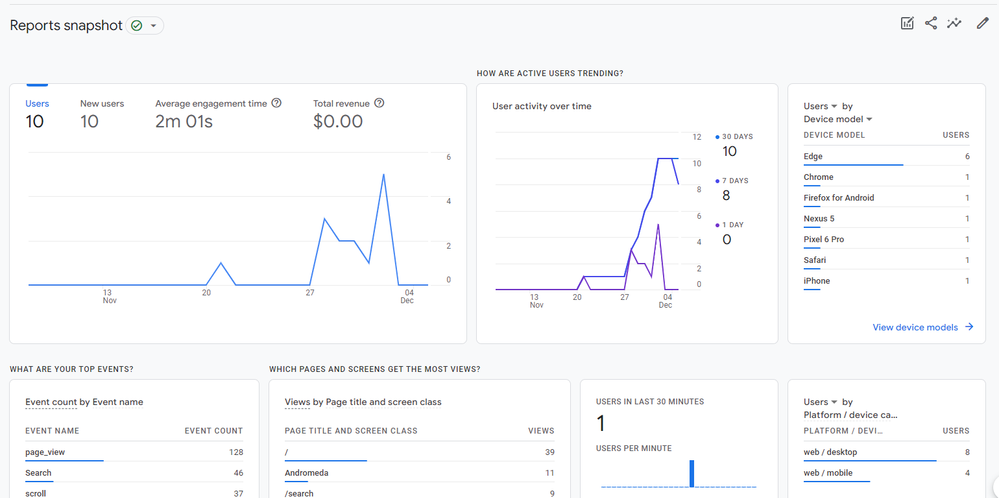

You’ll know it’s working when you see the information for your site such as page titles/URLs, page views, and events in your Google Analytics account.
Not seeing any metrics yet? Don’t worry, over the next few days check back in as metrics accrue, and make sure you have the tracking date range set to overlap with when you added it to your site.
