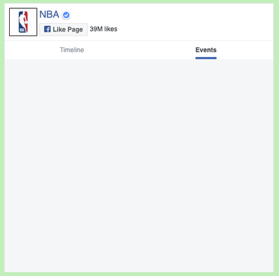

If you are using the Social media card on ArcGIS Hub or Enterprise Sites, you may have noticed an unexpected result with the Facebook Events feed. Hub and Enterprise Sites use Facebook’s Page Plugin to power their Social media cards. Over the past year, Facebook Events are not being shown under the 'Events' tab of the Page Plugin
Facebook initially acknowledged and assigned this bug, but they recently closed the issue without fixing the problem. As the Social media card relies on Facebook’s plugin to work properly, this outage has impacted Hub and Enterprise Sites. As such, the Hub team cannot resolve the underlying issue and suggests that users turn off the Event feed.  soc_med_cd_events.png

In a Social media card, let’s say you add a 'Post or Timeline Link' such as https://www.facebook.com/esrigis/. With 'Events' turned on, the ‘Events' tab should display either a list of events or a message: "Esri does not have any upcoming events." Due to the bug, the user sees only a blank page with no events listed and without any message about upcoming events. You can still turn on or off the 'Events' tab in the site layout editor, but the events feed is always empty.

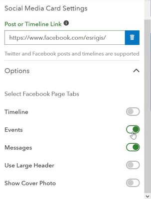

In the short term, the Hub team suggests that you switch off this functionality for Social media cards that embed Facebook pages. Simply turn off the 'Events' feed while editing your Social media cards in the site layout editor (within the Customize side panel).  soc_med_cd_events_toggle.jpg
