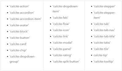

ArcGIS Hub and Enterprise Sites (11.2 forward)  support Calcite Design System components within the Text card. This gives site and page editors a simple way to add a variety of interactive elements to their site layouts. Calcite components are a “distributed set of composable, purpose-built web components for building great web experiences” (Developer documentation).
In the Text card, you can use nearly 30 different Calcite components. For layout editors, these components are easier to modify and maintain than the HTML snippets previously used. For site visitors, the components contribute to a clean, efficient, and positive user experience.
Calcite components supported by Hub and Enterprise Sites

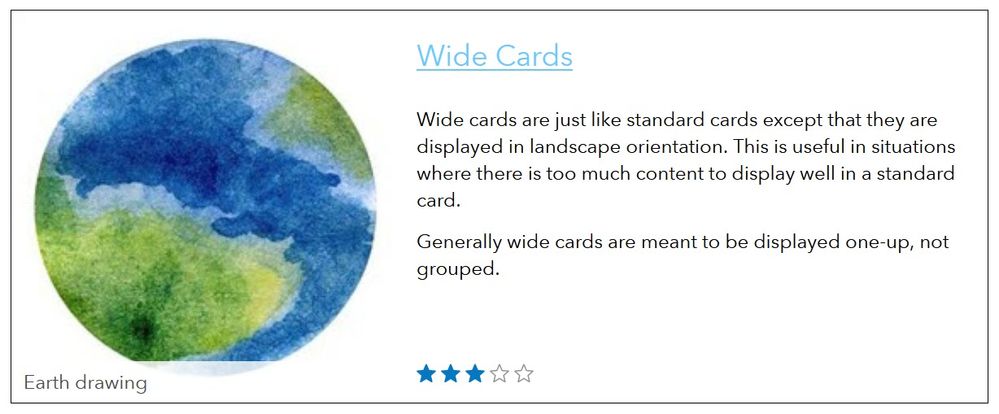

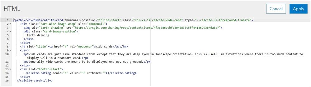

Cards are rectangular containers that can hold buttons, images, and other content. The Wide card and Cards options are customized versions of the Calcite “Cards” component. Wide cards are essentially the same as a regular card but appear in landscape format.
Calcite Wide card live
Calcite Wide card code
The Cards option adds three cards to the row card in the layout. You can add images, text, and singular or grouped buttons.
Calcite Cards live
To add images to a wide card and the cards template, the most common workflow is to use the URL of an image  hosted online. Don't forget to add alt text for screen readers and captions.

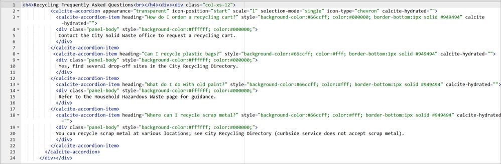

Accordions
Accordion components organize related text and can improve navigation on your sites and pages. They shorten pages by collapsing menus and lists and reduce unnecessary scrolling. Accordions are useful for adding frequently asked questions.
Calcite Accordion code
Repeat the accordion item tag <calcite-accordion-item></calcite-accordion-item> and attributes to add more sets of text to your list.

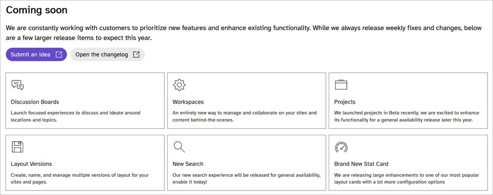

Calcite Tiles live
In this example from a Hub site built for the User Conference, you can see the use of Calcite Tiles and Buttons (with theming and rounded corners from Calcite).
Code for three of the tiles:
  <div>
    <div style="margin-top:1rem;display:grid;grid-auto-flow:column;grid-auto-columns:1fr;gap:0.5rem;">
      <calcite-tile heading="Discussion Boards" description="Launch focused experiences to discuss and ideate around locations and topics." icon="speech-bubbles"></calcite-tile>
      <calcite-tile heading="Workspaces" description="An entirely new way to manage and collaborate on your sites and content behind-the-scenes." icon="gear"></calcite-tile>
      <calcite-tile heading="Projects" description="We launched projects in Beta recently, we are excited to enhance its functionality for a general availability release later this year." icon="projects"></calcite-tile>
