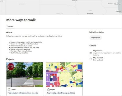

A: Hub initiatives are now stand-alone items in ArcGIS Hub and ArcGIS Online, which allow you to organize large-scale efforts within your organization and across partnered organizations. Hub initiatives have a unique live view that can provide context on the goals of the work, show where things are happening on a broad map, and measure progress using metrics. Hub initiatives can organize Hub projects, which have a narrower scope or location, through two-way associations. Initiatives can be featured on one or multiple sites that highlight the initiative’s work (either through a gallery card on the site layout, in the site’s header, or by being shared to a group that feeds the site’s content catalog).
Q: How are two-way associations managed?
A: Hub initiatives and Hub projects that serve the same goals can request, review, and approve association requests from one another within their workspaces. The editor of a Hub initiative can set up an association group within initiative workspace to oversee and manage associations with Hub projects; and they can bring in others as group managers to help. Hub project editors manage associations with Hub initiatives from project workspace.
Q: What happens when Hub initiatives and Hub projects are associated?
A: Once both sides approve association, fully associated Hub projects will appear on the initiative’s view and fully associated Hub initiatives will appear on the project’s view. If the initiative has selected to display a map as its hero element (configured during creation or on the Details pane of initiative workspace), the locations of fully associated Hub projects will appear on that map. This allows visitors to spatially browse the projects that contribute to the initiative’s success.
