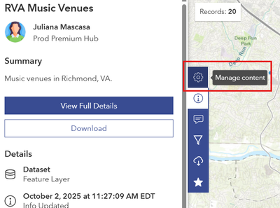

  1. From your dataset’s explore page, select the Manage content button to navigate to workspace.
    Manage content button on dataset explore page.Manage content button on dataset explore page.

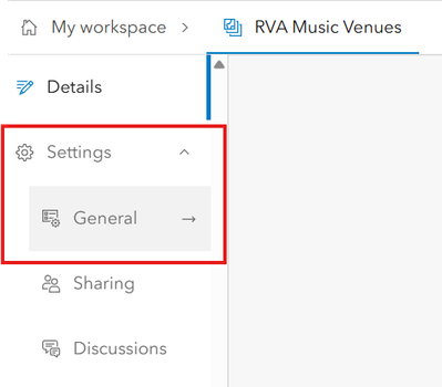

  2. From here, select Settings > General.
    Workspace general settings.Workspace general settings.

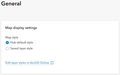

  3. You’ll now see a Map display settings section that allows you to toggle between the Hub default style and the Saved layer style.
    Map display settings.Map display settings.

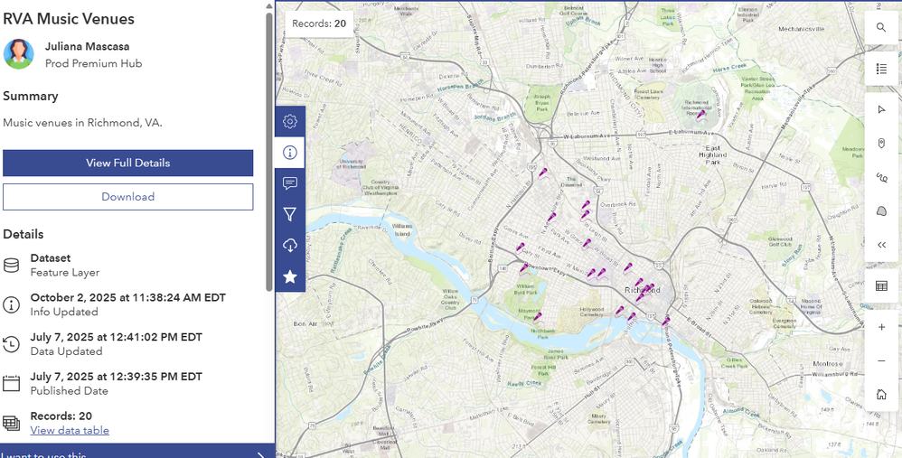

  5. Now, back in the workspace (General pane), when you select Saved layer map style, select Save, and return to the layer’s explore view in Hub, you’ll see the updated style.
    Saved layer style option in map settings.Saved layer style option in map settings.
    Updated layer style in explore page.Updated layer style in explore page.
