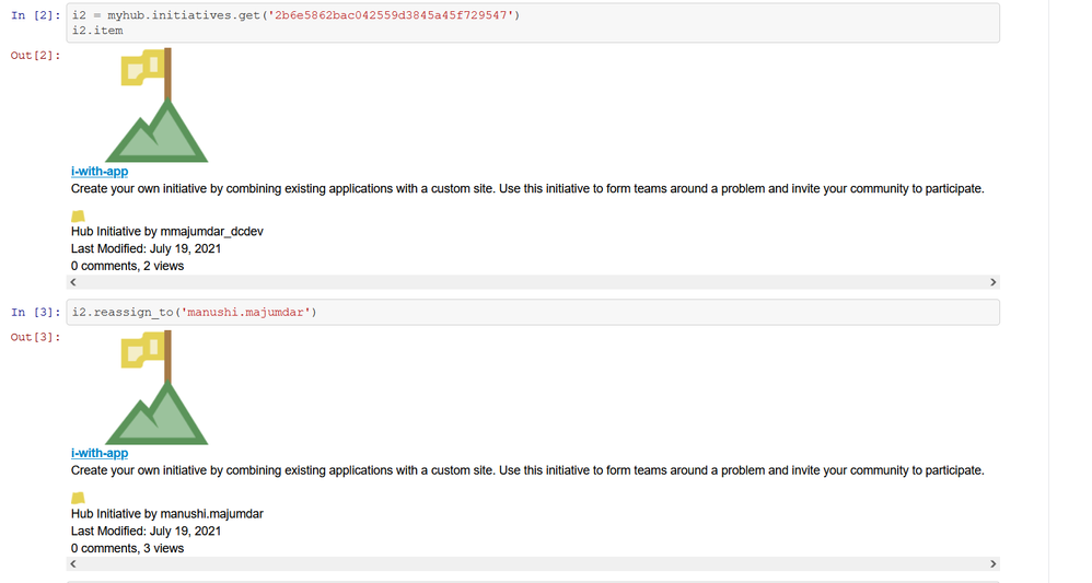

The two-step process to reassign an initiative or site to a new user is as demonstrated below. You start by first fetching the initiative or site and then assigning it to a new user. Click on the below image to see this example guide.
Before you get started, review the following:
  1. Only the administrator of an organization has privileges to perform this task.
  2. ` target_owner` must be the username of a user who belongs to the same organization. If you wish to add this initiative to another organization, you may clone it instead.
  3. If you have sites created with ArcGIS Hub Basic or ArcGIS Enterprise, you can reassign them to another user using the same process with a slight change in the first step. You will fetch the site instead of initiative from the collection of sites (`myhub.sites.get(itemid)`).

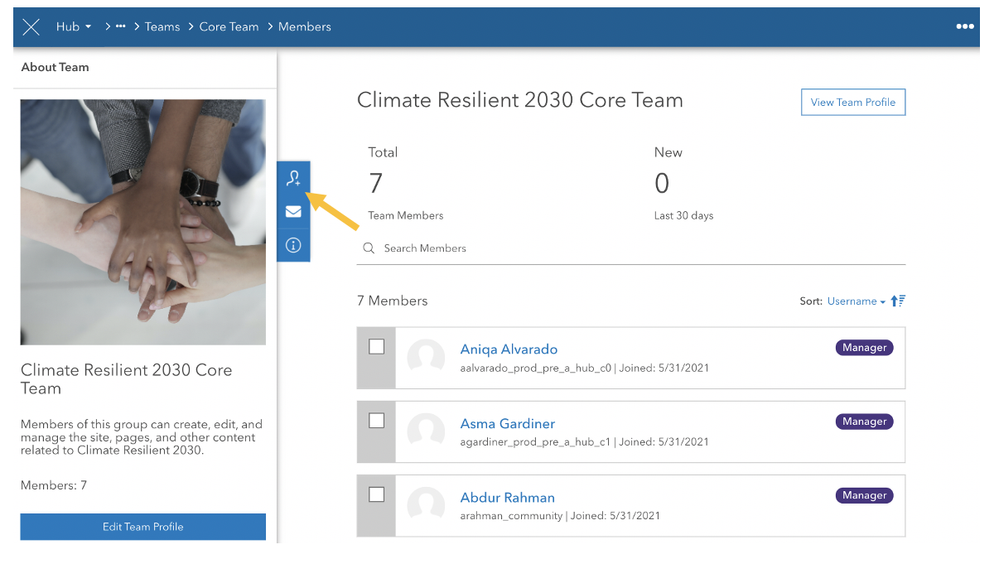

  4. Ensure that the new owner is a member of the core team by clicking the site's second dropdown menu and choosing Teams
  5. Open the site’s core team and click the add team members button to add the new site owner to the group.  KatelynThompson_1-1627568219599.png

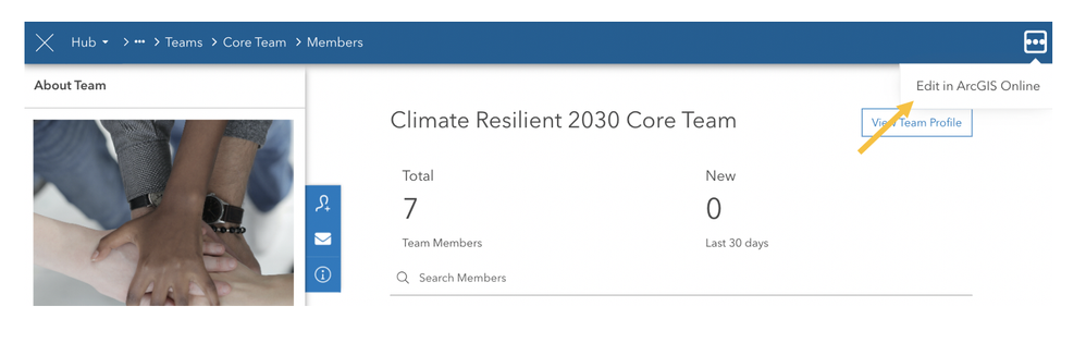

  6. Next, open ArcGIS Online by clicking the more button and clicking Edit in ArcGIS Online. You will complete the remainder of the workflow in ArcGIS Online.KatelynThompson_3-1627568297659.png

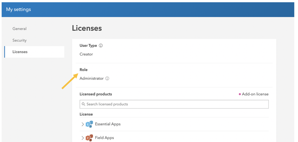

  7. Ensure that the new owner has an ArcGIS account with your ArcGIS Online organization (or Enterprise Portal) and has at least the minimum privileges to create and manage sites or initiatives.
    1. Click on the new owner’s name and choose View Profile.
    2. Click View Settings and Licenses and look for the role. KatelynThompson_6-1627569148340.png
    3. If you need to adjust the role, follow the steps provided in Assign a default role (for administrators) or Configure a custom role (initiative/site managers) if you don’t have this role set up yet.

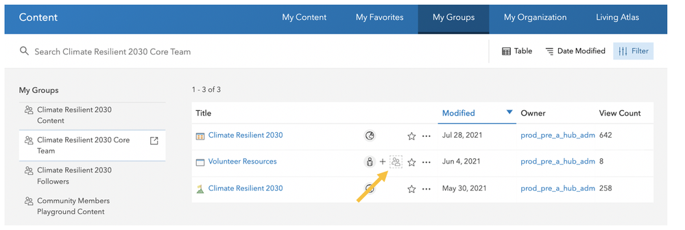

  8. Un-share each item in the core team in ArcGIS Online. Items belonging to a Shared update group (groups that grant edit access to its members) cannot have their ownership changed until they are removed from the group.
    1. Click the My Groups tab and open the core team group.

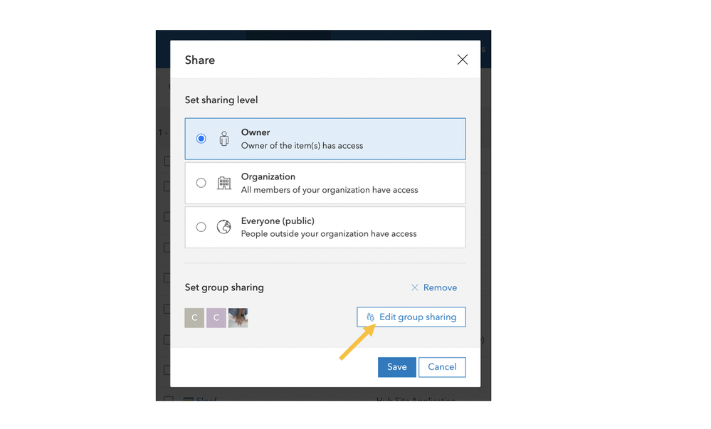

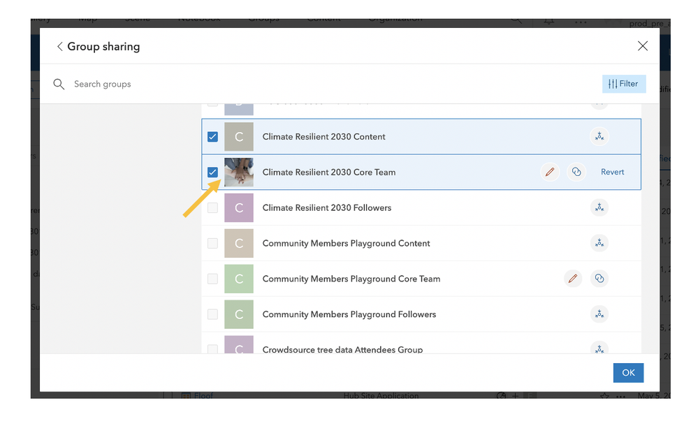

    3. Click Edit group sharing.KatelynThompson_8-1627569438556.pngd. Un-check the checkbox for the group and click OK.KatelynThompson_11-1627569803379.png

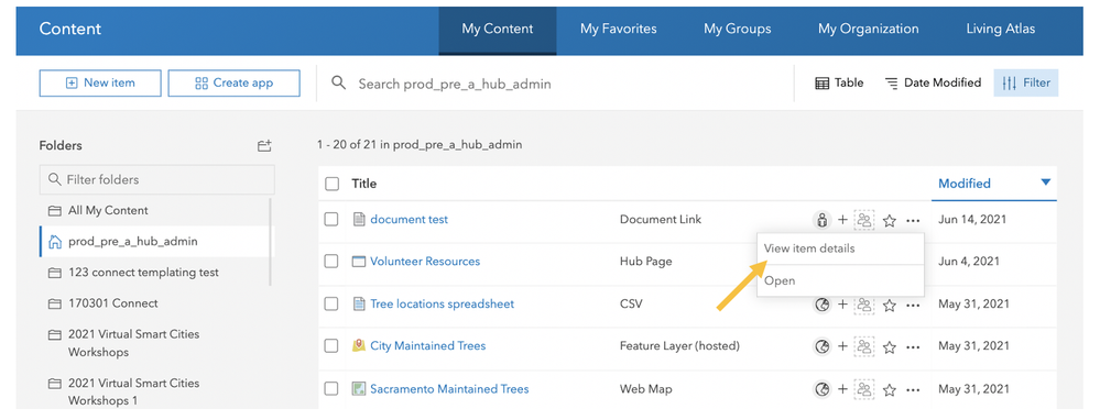

    1. Click the sharing icon and choose View item detailsKatelynThompson_12-1627569866120.png

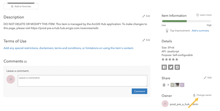

    2. On the item details page, click Change owner.KatelynThompson_16-1627569992481.png

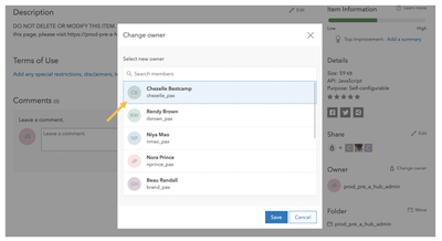

    3. Select the new owner and click Save.

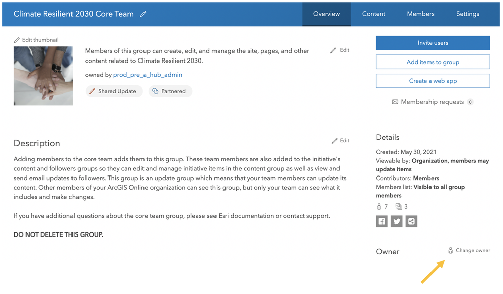

  12. Once all items have been shared to the core team group, change the ownership of the core team group  to the new owner.
    1. Click My Groups and select the group to open its group details page.
    2. Click Change owner and select the new owner. KatelynThompson_20-1627570730755.png
