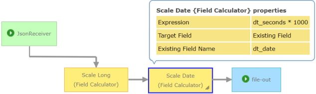

There is no problem including multiple Field Calculator processors in a single GeoEvent Service. You sometimes have to "chain" a series of Field Calculators together to compute intermediate values and then perform calculations on those intermediate values. An example of this can be seen in the GeoNet thread How to switch positions on coordinates
If you know that data you are receiving is in epoch seconds, you can scale the received Long integer value by multiplying by 1000 and write the computed result to a field whose type is Date. For example, illustrated below is a GeoEvent Service whose input receives a single long integer value. The GeoEvent Definition used by the input has two additional fields, another Long and a Date, who's values are adapted as null when no values are provided in the received data structure. The first Field Calculator multiplies dt_seconds (a Long) by 1000 and writes the result into a field dt_long (also a Long). The second Field Calculator uses the exact same expression but writes the result into a field dt_date which forces the Field Calculator to perform an implicit conversion from long integer to Date.
I've chosen to show the input as JSON received over REST and the output as delimited text as that makes it clear what the data values are.
Input[{"dt_seconds": 1613600457}]
Output:  JsonReceiver,1613600457,1613600457000,2021-02-17T14:20:57.000-08:00
Note that the name of the GeoEvent Definition used by all nodes in the GeoEvent Service is JsonReceiver (the TEXT outbound adapter prepends that to the comma delimited values is produces). Also, the TEXT output can be configured to format Date values as ISO 8601 (as shown). You can use https://www.epochconverter.com to convert either the dt_seconds or the computed dt_long to show that either can be used by a system to represent the date/time shown formatted as an ISO 8601 string.

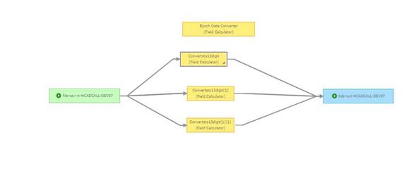

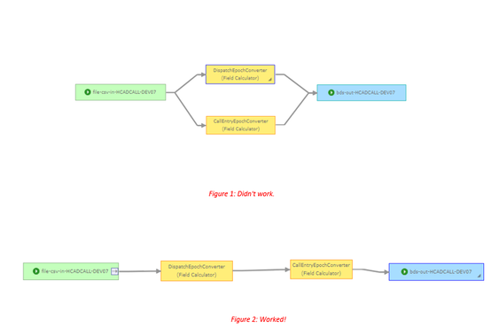

The issue I am having now is with Epoch Time. I was able to use a Field Calculator to convert my 10 digit epoch time value to 13 digits and Geoevent imports that fine in MM-DD-YYYY format. However, I have multiple such fields and when I use multiple Field Calculators, the conversion doesn't happen properly. Some fields retain epoch time while others show mixed results. So I guess my question is, can we have multiple Field Calculators in the same geoevent service?

Ctal_GISsquad
Thank you. That indeed helped. Instead of  connecting field calculators along different paths, I stacked them one after another and that seems to have done the trick.
