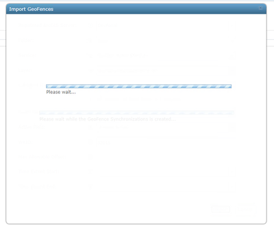

I have a fairly large table (350,000 records) that contains polygons that I would like to use for my geofences in Geovent Server. I published this as feature service so Geoevent Server can read it. The feature service works fine. However, I cannot import these records as a geofence in Geoevent Server. It just loads for about 10 minutes (pictured below), then the box disappears and it acts as if there are no geofences. There are not any error messages or anything useful in the logs. I am able to get it to work with a small number of records, but not with a large amount of records. Is there a limit to the number of geofences I can have in Geoevent Server? My resource usage on the server is fine, CPU doesn't get above 25% and RAM usage is less than 50%.

Thank you for your response! I was actually reading another article that was talking about increasing the RAM allocation. I've done a lot of testing, and initially, the geofences were failing without any error when I asked this question. But after simplifying the geometry and trying to re-import them again, it actually was able to import several thousand before failing, and the GeoEvent server logs stated that it ran out of memory.
The initial failing without any error messages is what caught me off guard, but I realize that it was probably way too big and complex for it to even try to import any and provide any useful messages.
