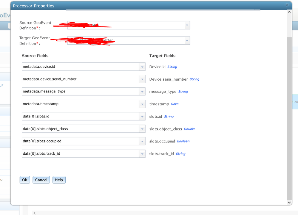

Hello everyone,
I am trying to parse a json event in geoevent 10.7.1 using a field mapper, in order to flatten the structure and be able to access the indexed objects, yet i keep failling.
Here's how my field mpper looks like :
So, instead of getting the simple structure as defined in my target geoevent definition, i keep getting the initial structure.
Any ideas please ?

Hi @kavi88,
I believe the issue is how you're specifying the array.  Try data.slots[0].id.

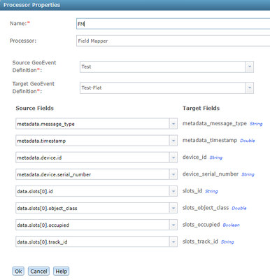

Here's what worked for me:
  1. Flattened the output GeoEvent Definition using the following script
  2. Created a Field Mapper as below:
JeffSilberberg
Take your source data and run it through https://jsonlint.com/.  You will see that you have an array inside the data object but the data object is not an array.
So data.slots[0].id looks like it might make more sense...  But I also have issues when working with arrays inside GeoEvent so let us know..

kavi88
hello JeffSilberberg , JakeSkinner,
Thank you so much for your fast reply. it's now working as i want it !
