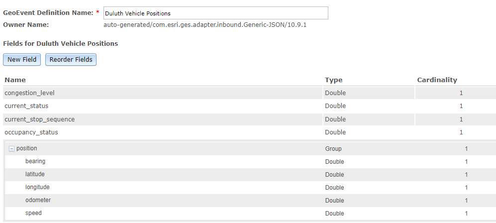

You may work with GeoEvent Definitions that contain Groups.  For example, here is a GeoEvent Definition called Duluth Vehicle Positions used for an AVL feed:
There is a Group called position that contains many fields within it.  You may find the need to create an output feature service in a ArcGIS Online or a relational/spatiotemporal data store using GeoEvent.  However, you will be unable to do so using a GeoEvent Definition that contains a group.  Instead of going through the tedious task of recreating this GeoEvent Definition, you can use the below Python script to ungroup/flatten the GeoEvent Definition, which will essentially remove the Group types, but retain the underlying fields.

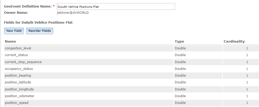

After executing the above script, a new GeoEvent Definition called Duluth Vehicle Positions-Flat is created:
The Group position has been removed, but the underlying fields (bearing, latitude, longitude, etc) remain.  This GeoEvent Definition can now be used to create feature services within the relational or spatiotemporal data stores.

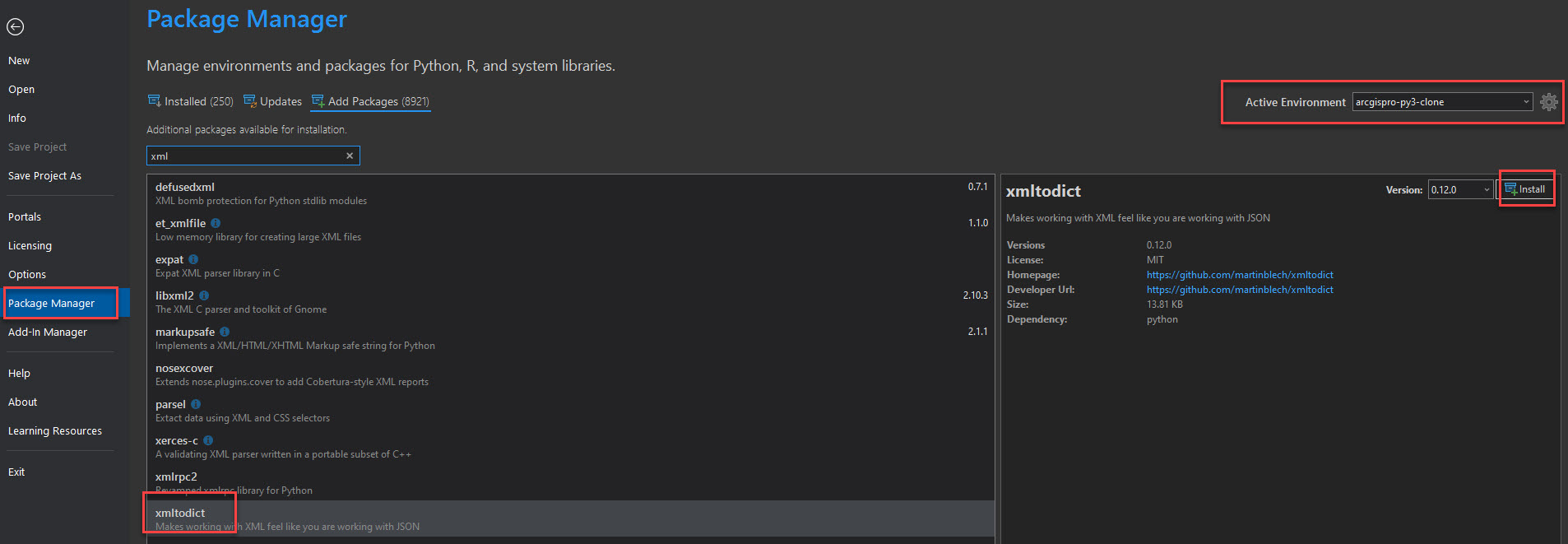

Update 8/23/2023:  The updated code will work with nested groups.  Another module, xmltodict, is required to execute the script.  If you are executing this script where you have ArcGIS Pro installed, you will need to install this module.  First, you will need to clone the default environment.  Once cloned, switch to this environment, search for the xmltodict module, and install:

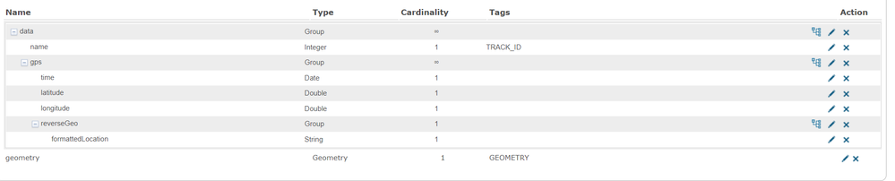

bnmcknigh
Jake this is great! Can this be used on nested groups? NestedGroups.PNGNestedGroups.PNG
EricIronside
@bnmcknigh
I'll let Jake comment on whether his script will work with nested groups (it probably does or could be made to easily).
Another option would be the Multi-cardinal Field Splitter. Not ideal, but you can chain them together for multiple nested groups.

JakeSkinner
Esri Esteemed Contributor
@bnmcknigh I must have missed your comment previously.  Recently, I was working with a definition that had nested groups, and the original code did not work.  However, I updated the code (see above) and the new version works.
