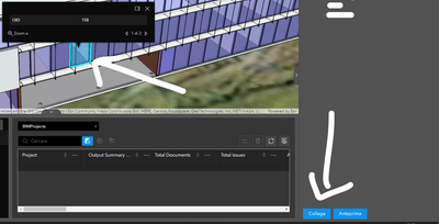

- when I try to link an object the first time, it doesn't work (picture 1)

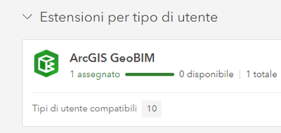

- If I click on the web scene (for example, the basemap), and then a second time on the same object, it works (picture 2)
I know it sounds weird, but this "solves" the problem.
May be a bug?

by Anonymous User
Not applicable
Thanks for the snapshots. Yes, that seems like a bug. If you are able to select it the first time, it should enable you to add a link like you're doing on the second time you select the same feature. We are going to need to look into this further and see if there is something we need to update for this to work on first selection.
