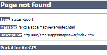

When connected to our ArcGIS Enterprise (10.8.1) environment, opening search results from Chat will fail (see below for the error message). When I Open in browser, it uses a malformed URL which I can correct as follows (I've highlighted the incorrect and corrected part of the URL):
  • FAIL - https://{Portal DNS}/arcgis/apps/mapviewer/index.html?webmap={OID}&arcgis-auth-origin=https%3A%2F%2Farcgis4teams.arcgis.com&arcgis-auth-portal=https%3A%2F%2F{Portal DNS}%2Farcgis%2Fsharing%2Frest
  • SUCCEED - https://{Portal DNS}/arcgis/home/webmap/viewer.html?webmap={OID}&arcgis-auth-origin=https%3A%2F%2Farcgis4teams.arcgis.com&arcgis-auth-portal=https%3A%2F%2F{Portal DNS}%2Farcgis%2Fsharing%2Frest
