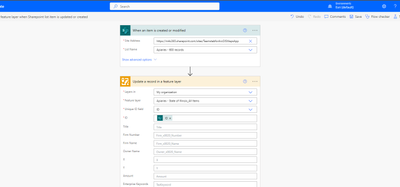

Regarding updating ArcGIS feature layer when new items are added to a Sharepoint list or when updates are made to existing items, please use the steps below in Power Automate,
1. Create a new flow - use the "automated flow" as the option
2. Choose the action"When an item is created or modified
3. Populate the site address of the Sharepoint site where the list resides
4. Enter or populate the list name using the drop-down
5. Add the action from "ArcGIS" connector for "Update a record in a feature layer"
6. In the ArcGIS action, populate the fields "Layers in", "Feature layer", "Unique ID field", "ID". Here's an example
7. Run the "Flow checker" to validate the flow
8. Save and Run the flow
Anytime the list specified in the above flow is updated, the feature layer will automatically get updated.
