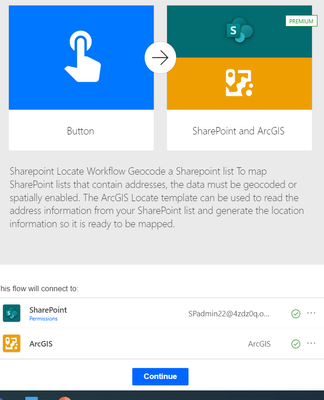

The SharePoint locate workflow template can be downloaded from the Power Automate templates catalog. Search the Power Automate templates catalog for “SharePoint Locate Workflow”.
Note: I need to sign in with my SharePoint org credentials in order to download the template.
Click on “Continue”.

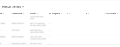

Now let’s geocode the below SharePoint list, using the downloaded Power Automate template.
As you can see in the above image, the SharePoint list contains a column with addresses for Apiaries in the state of Illinois.

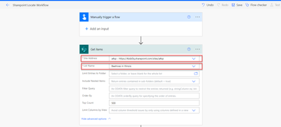

Step 1
 In step 1, I will point the “Site Address” to the SharePoint site containing the SharePoint list. Also, I will specify the “List Name”. Optionally, I can also specify the “Top Count” for the list (total number of rows in the list)

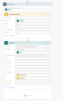

In step 2, the “Apply to each” action will loop through each row in the SharePoint list and will terminate when it reaches the last row in the SharePoint list.
In the “Find address candidate” custom ArcGIS connector, I will first “Add new connection” by opening the menu for the connector (click on the ellipsis"...") and the credentials for your ArcGIS org account. Next, I will choose “Yes” to store results. In the address field of the “Find address candidate” of the connector, we will specify the column in the SharePoint list that contains the addresses. Also, specify the country to be used by the geolocator, in this case its “United States”.
Once the “Find address candidate” ArcGIS connector is able to geocode the SharePoint list, the next action is to update the SharePoint list with the coordinates for each row.
As you can see in the above image, I have added columns X,Y in the SharePoint list to store the coordinates output from “Find address candidate” connector.
In the “Update item” connector, we will once again point the connector to the site containing the SharePoint list and also specify the name of the SharePoint list that has to be geocoded.
The “Id” field in the “Update item” connector has to be mapped to the “ID” derived from “Get items” in Step 1.
Since I want to store the output from “Find address candidate” in columns X and Y, we will map X to “Longitude (X)” and “Latitude (Y)”.

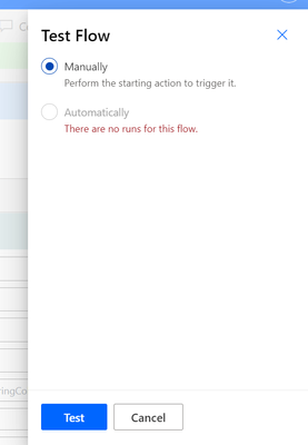

Since this flow is triggered manually, choose the option “Manually” and click “Test”.
Once the test run is kicked off, the status of the flow is displayed at the top.

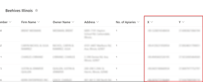

After the flow runs successfully, I can now check the SharePoint list to see if it’s geocoded.
The image above shows the geocoded SharePoint list with the coordinates corresponding to each address populated in columns X and Y.
