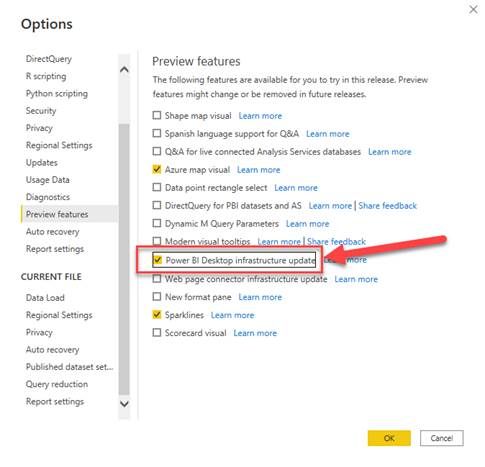

Our Product Engineers have found that Microsoft enabled a setting on by default that was previously turned off. You can UN CHECK this setting, and the boundary matching should work as expected.
Laura_May
This worked - thank you very much 🙂
