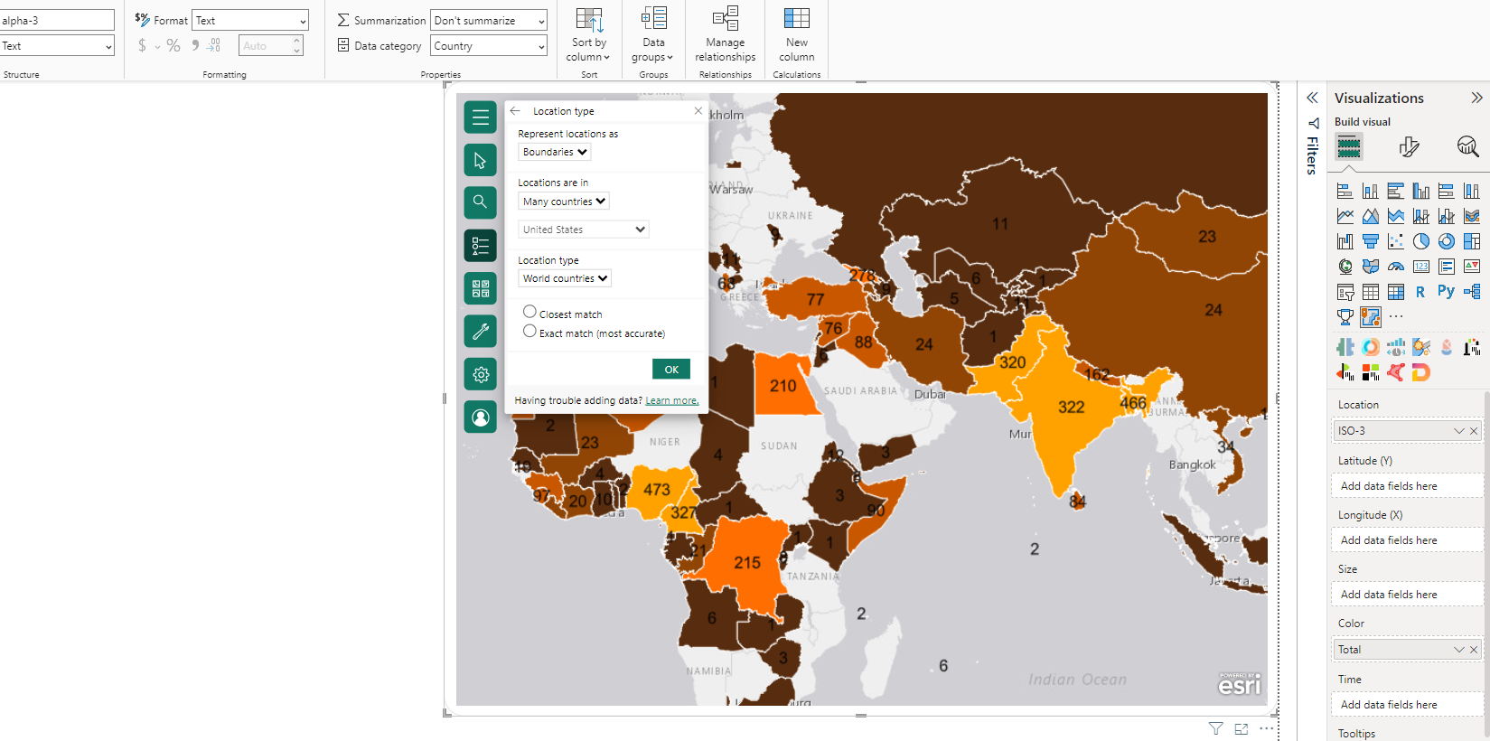

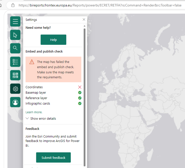

I have created a Map on Power Bi desktop using the Country ISO-3 code as location specifying in data category that this is country. While it works well in the report when I publish on power bi server validation rules are not passed and error shown is Coordinates are missing.  So the question is how I could overcame this since there are no coordinates for visualising world countries that are boundaries and not points?
I am adding below two screenshots first from report before publishing (you can see fields in visulisation pane and data category on top) and the second with the error when I check validation. I would appreciate any help

Hi @NikosZarkadoulas,
Thanks for your question. For embed and publish report, please see more info here. In order to embed and publish, Location field well only supports for EsriJSON format data. You could convert the boundaries data to EsriJSON format.
