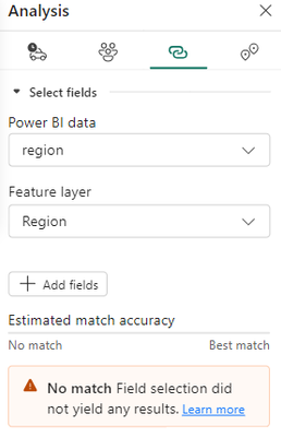

We have discovered that a side effect of yesterday's 2024.2.550 update has resulted in text-based joins to no longer work. Files that had existing text-joins (setup using the previous version) are now broken and new joins fail to find any matches during validation. This is a major bug that has needs to be fixed immediately!

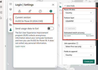

Hi @JCable and @LydiaStekkinger ,
Thank you for bringing this to our attention. We are pleased to inform you that the bug you reported has been resolved in the latest update of ArcGIS for Power BI (version 2024.2.560). To access the fix, please restart Power BI.
Should you encounter any further issues or have additional questions, please don't hesitate to reach out. We're here to help!

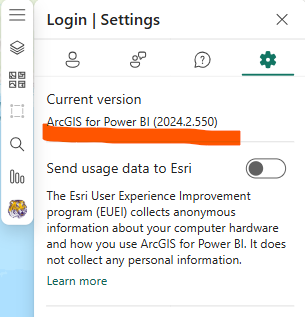

ArcGIS Enterprise version: 10.9.1
Power BI version: 2.138.1004.0
ArcGIS for Power BI version: 2024.2.550

Yes, I am trying to create a join between a table in Power BI and an ArcGIS Feature Service layer. When I set the 'Power BI data' and 'Feature layer' field dropdowns to matching string fields, I get an error that says "No match. Field selection did not yield any results." and I cannot create the join. This worked as recent as last week
The error does not occur if I select numerical fields.
