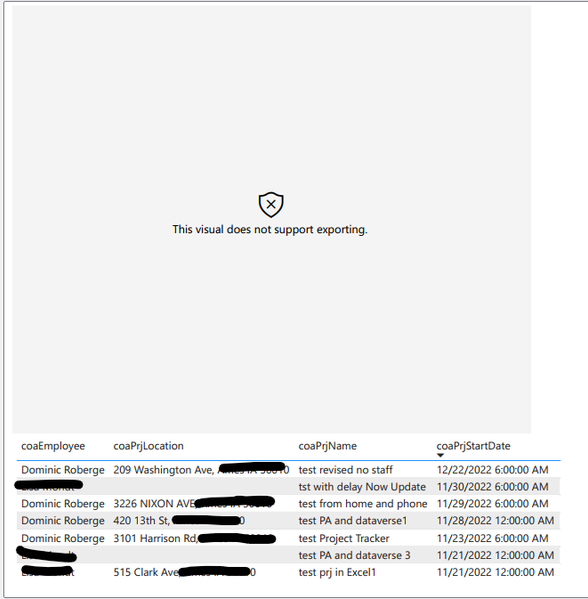

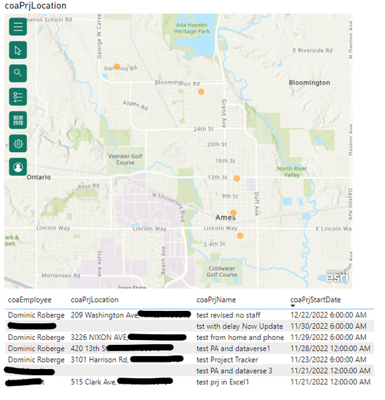

I created a simple report in Power BI (Map and table) and when I try to export to PDF, the map widget return this:
is this a known issue?

@DominicRobergeIADOT - Thank you for reaching out. This is working as expected. Our visual is currently not certified with Microsoft as we are considered a third-party visual.
Please let me know if this helps!
Reference: Get your Power BI visuals certified - Power BI | Microsoft Learn
