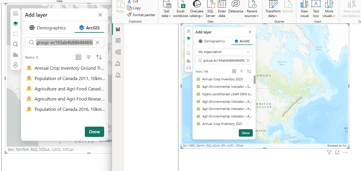

Hello. I’m trying to search for a publicly available set of layers from the Government of Canada using the ArcGIS for PowerBI visual. When I search by the group ID while not signed in (guest mode), the group and its layers do not appear in the search results.
If I sign into my ArcGIS Online account in Power BI, I can find the group and access its layers without issue. The layers themselves don’t seem to be the problem — I can locate the same open data layers directly in ArcGIS Online without signing in.

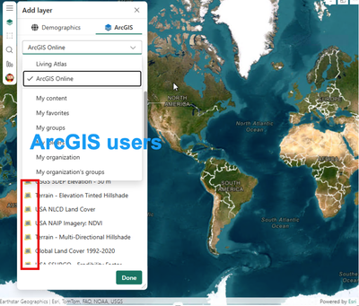

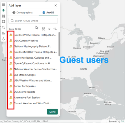

I've also attached a screenshot of the searching results of the logged in and guest accounts

For guest users, only public feature layers are available for them;
For ArcGIS users, ArcGIS for Power BI will support much more: Living atlas, ArcGIS Online and layers from your org. The layer types supported include: feature layers, map image layers, web maps, imagery layers, vector tile layers and WFS.
So that's why when you are a guest user, you only see part of the layers returned and all of the results when sign in to ArcGIS.
