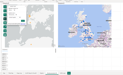

I've just tried with partial postcodes myself after reading your posts and get the same result you do:
Bottom is a table of random partial postcodes, left is an ArcGIS map and right is a regular "map" visual.
ArcGIS doesn't seem to like partial postcodes so places some of them somewhere along 0 degrees longitude, whereas "Map" appears to handle them fine.
I don't know enough about geocoding in ArcGIS or in Microsoft to be able to tell you if either is right, or "map" just looks more right than ArcGIS but is still incorrect.

Thanks for taking a look into this for me, and for confirming that it isn't just a local issue on my end! It looks like the white space in-between the outcode and incode was causing the issues as per LeslieUK's solution on this thread. Replacing those with underscores has seemed to have solve the problem
