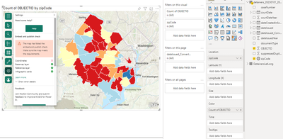

Are there any updates on being able to publish without coordinates? I really need to protect privacy by aggregating to zip code. Sometimes that is the only location data in a table. Using 2023.2.187

Thanks for your question! Currently, ArcGIS for Power BI only support Coordinates(XY) and EsriJSON (in the Location field well) in order to embed and publish your report.
We will update if there's anything new.
