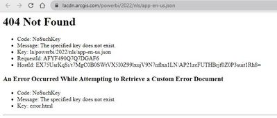

Good Morning,
I am having similar issues with my reports when using public facing links. In the report published to the workspace, everything functions correctly and my account shows logged in. When I open the public facing link, my credentials don't appear to propagate through correctly. Clearing the cookies and cache does not seem to be a fix. Is there a fix for this or what am I possibly doing incorrectly in the publish process?
NickEtchegaray
@Anonymous User is there any chance you can possibly look at my issue?
