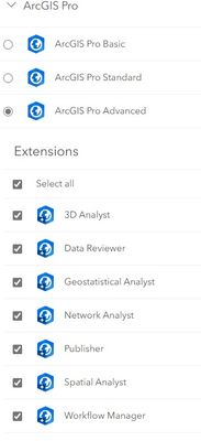

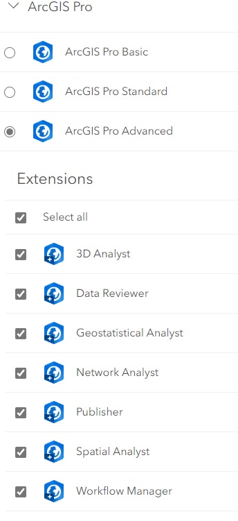

However I don’t believe the Data editor role contains the "createItem" property. Here are my available extensions.
If someone could explain what I'm missing or what exactly we need to change that would be great. Both myself and my administrator haven't a clue.
