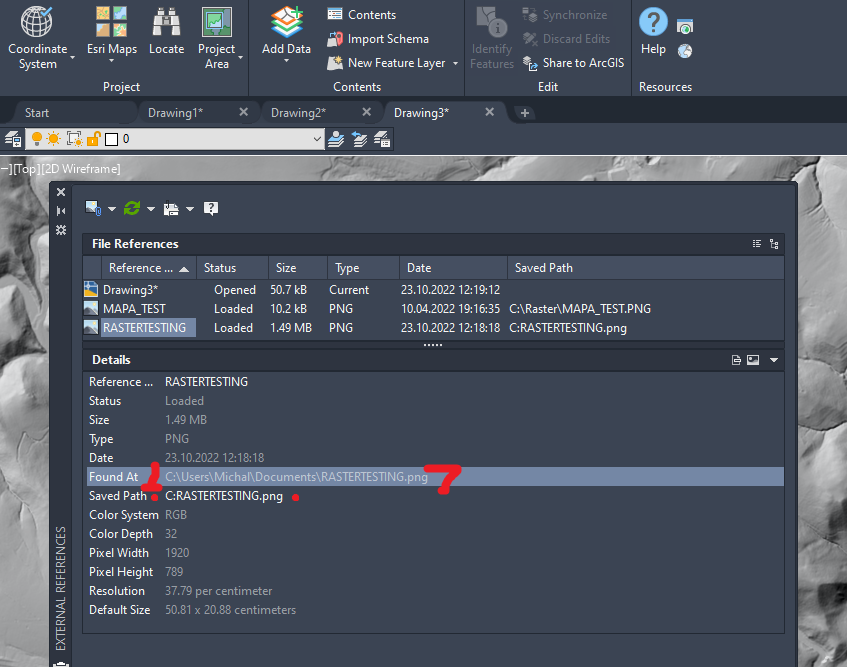

Hello,
I want to ask if the "esri_maplayer_extract" function works correctly or where I'm making a mistake
When I use this function: (esri_maplayer_extract 1 "C:\RASTER\TESTING.png")
The map is not saved in the correct directory. It looks like the function ignores backslashes and the directory name is appended to the file name.
Am I making a mistake when entering?

In AutoLISP and Common LISP the backslash is considered an escape character. So, if we want a literal backslash it must be escaped.
(esri_maplayer_extract 1 "C:\\RASTER\\TESTING.png")

michaljanda
Hello Dan, thank you. It works 👍
