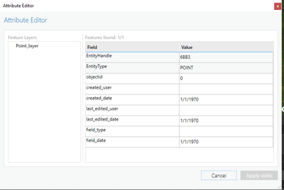

Hello,
Has anyone else had the issue of the default date field when creating a new feature in a Web Feature Layer is set to 1/1/1970? I have tried creating a self hosted feature on our portal and a enterprise geodatabase published feature layer and both give me the same result. Is there a configuration that I need to check in Civil3D or is this a ArcGIS for AutoCAD issue?
.Create feature dialogCreate feature dialog

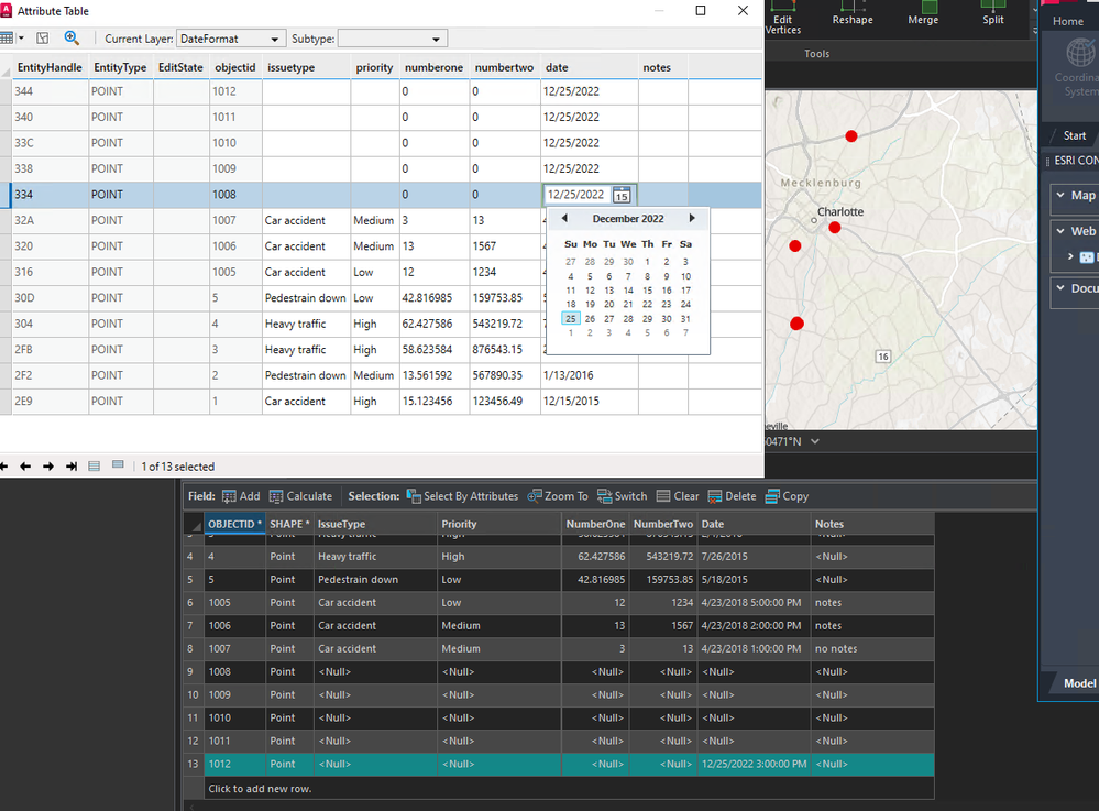

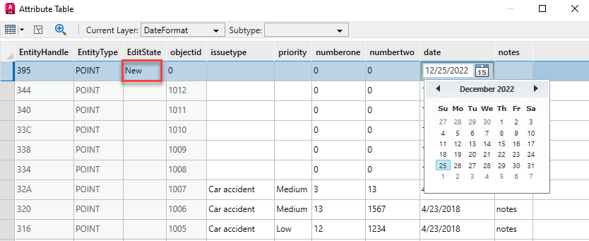

If you were to open the same Web Feature Layer in the web Map Viewer those <NULL> fields would actually be blank. However, in Autodesk verticals for the null numeric or date field the null value is actually filled in with what looks like a number and or in this case a date when in fact this is a default place holder. I you want to avoid seeing the default of "1/1/1970" a default date value could be set on the ArcGIS side that is then displayed instead within ArcGIS for AutoCAD, like so:
