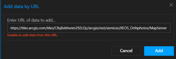

We are trying to consume hosted Tile Layer (which is published on ArcGIS Online) in AutoCAD using ArcGIS for AutoCAD.
However, when I use ADD Data by URL, it shows that Unable to add data from this URL.
Also, I could not find The tile layer in Add window of ArcGIS for AutoCAD.
(I could add Map Image Layer to AutoCAD)

We appreciate your use of ArcGIS for AutoCAD. "Map image layers and imagery layers that support the export map capability are supported by ArcGIS for AutoCAD. Certain web layers such as tiled map layers and vector tile layers may not be supported." As you have found, the Add Data UI will filter out unsupported layers for the user. The following help documentation discusses this: Map layers and imagery layers
Now if the tiled image layer you are trying to add to ArcGIS for AutoCAD was created from your organization there is an alternative. When the imagery is published in ArcGIS Online simply publish the image layer as a dynamic image layer instead.

Is there any way to view tile layers in AutoCAD if you don't have an Image for ArcGIS Online license? We are having a similar issue where entering the service URL gives an error "tile-only layers not supported". Could we add the mosaic dataset directly or something like that to get around it?
DanWade
Hello @mthompson,
You will not be able to add a mosaic dataset to a drawing. ArcGIS for AutoCAD has no way to add any imagery layer other than those using dynamic service.
KevinMacLeodEV
WMTS and WMS are also working alternatives.  From natively adding from the AutoCAD Display Manager.
