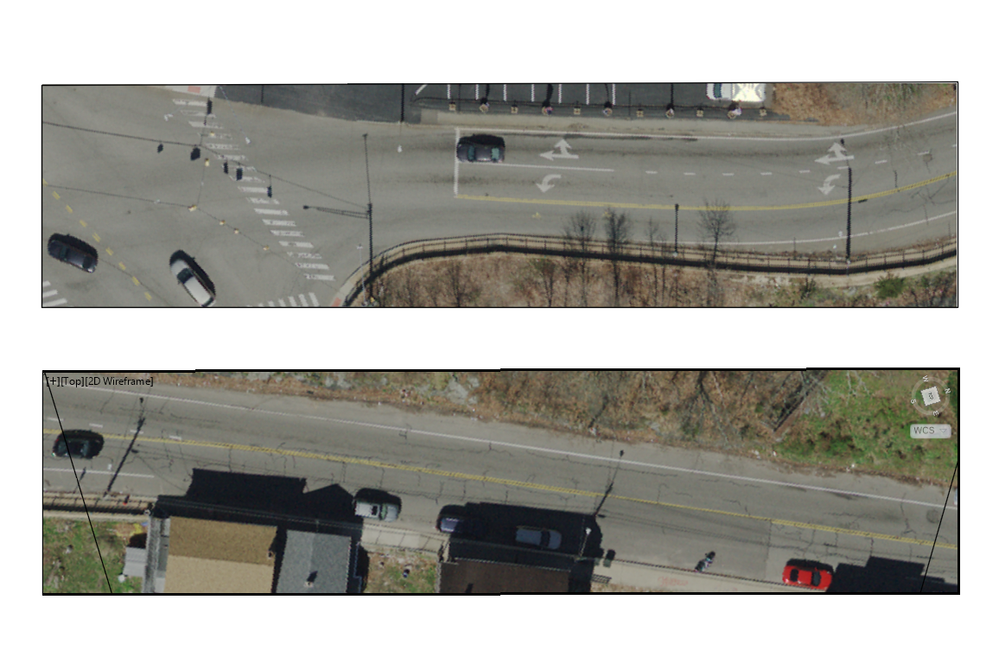

Hello, I used Add Data by URL in the ArcGIS tab of AutoCAD 2026.

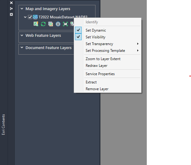

In the Model tab, from the Esri Contents panel, I used the Extract setting to create "screenshots" of what I wanted to print in the Layout tab.

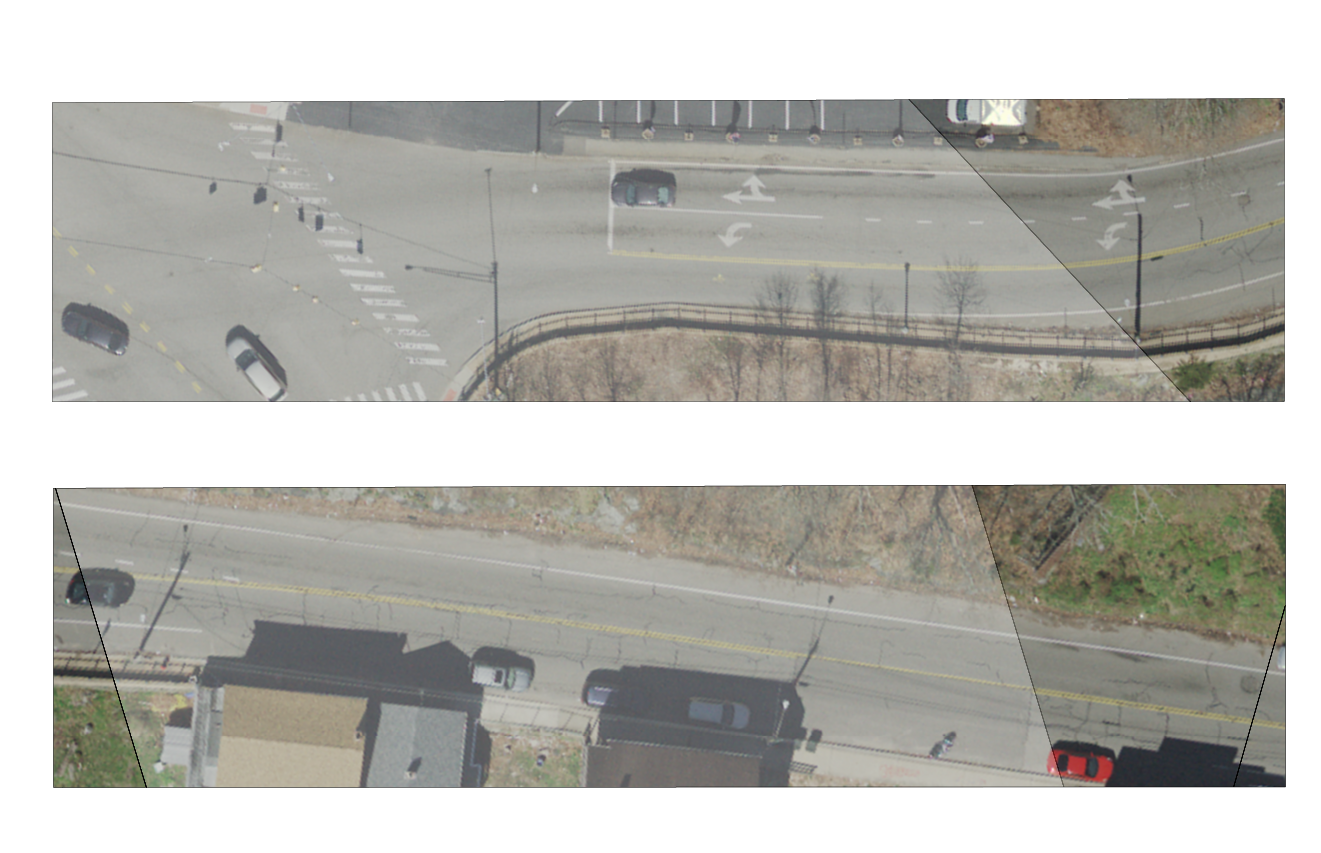

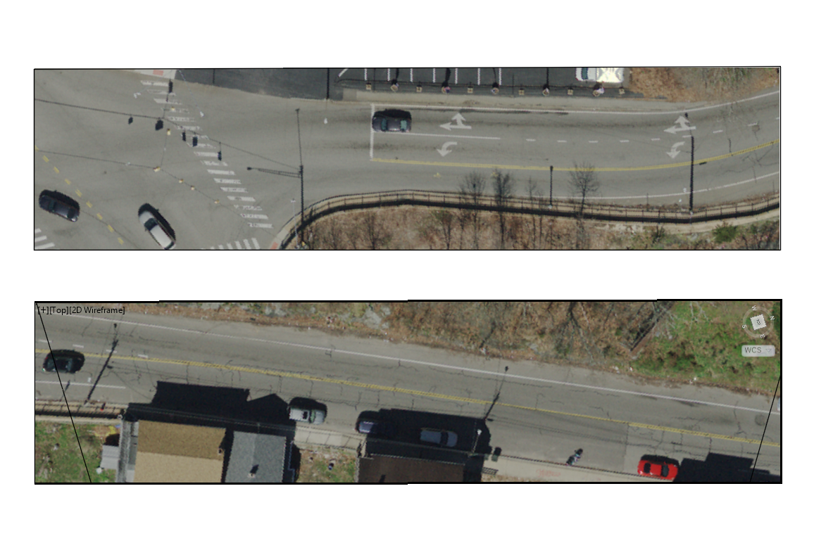

In the Layout tab, my images look fine. But when I print to PDF, I get these ghosty layers (see comparison below). How can I fix that?

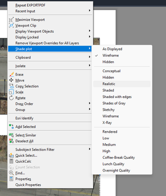

I figured it out.
In Paper space, right click the viewport, then Shade plot, then Realistic.
