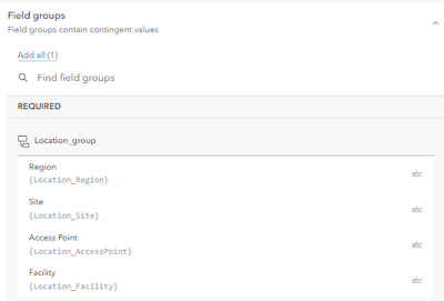

I have set up a field group with Contingent Values to help filter combo box fields on my form. For some of these fields, I am using Calculated Values to populate default values to save users time.
The contingent values function properly within the form but once the user has filled out all the fields in the field group, Field Maps displays the error: 'Value combination is invalid' and then the survey can't be saved.

OliverIshmael
There are 4 fields within the field group:
Calculated Values are used to populate Region and Site. Initially these are blank but once the user picks values for Access Point and Facility, then Region and Site are filled in correctly by Field Maps. However, when the user clicks to the next field it then displays the error that combination is invalid.
