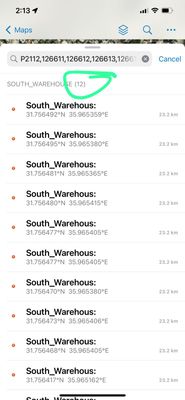

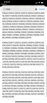

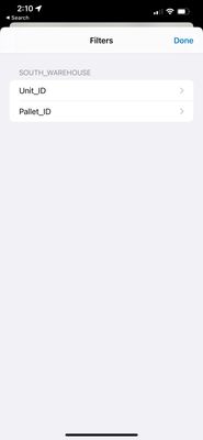

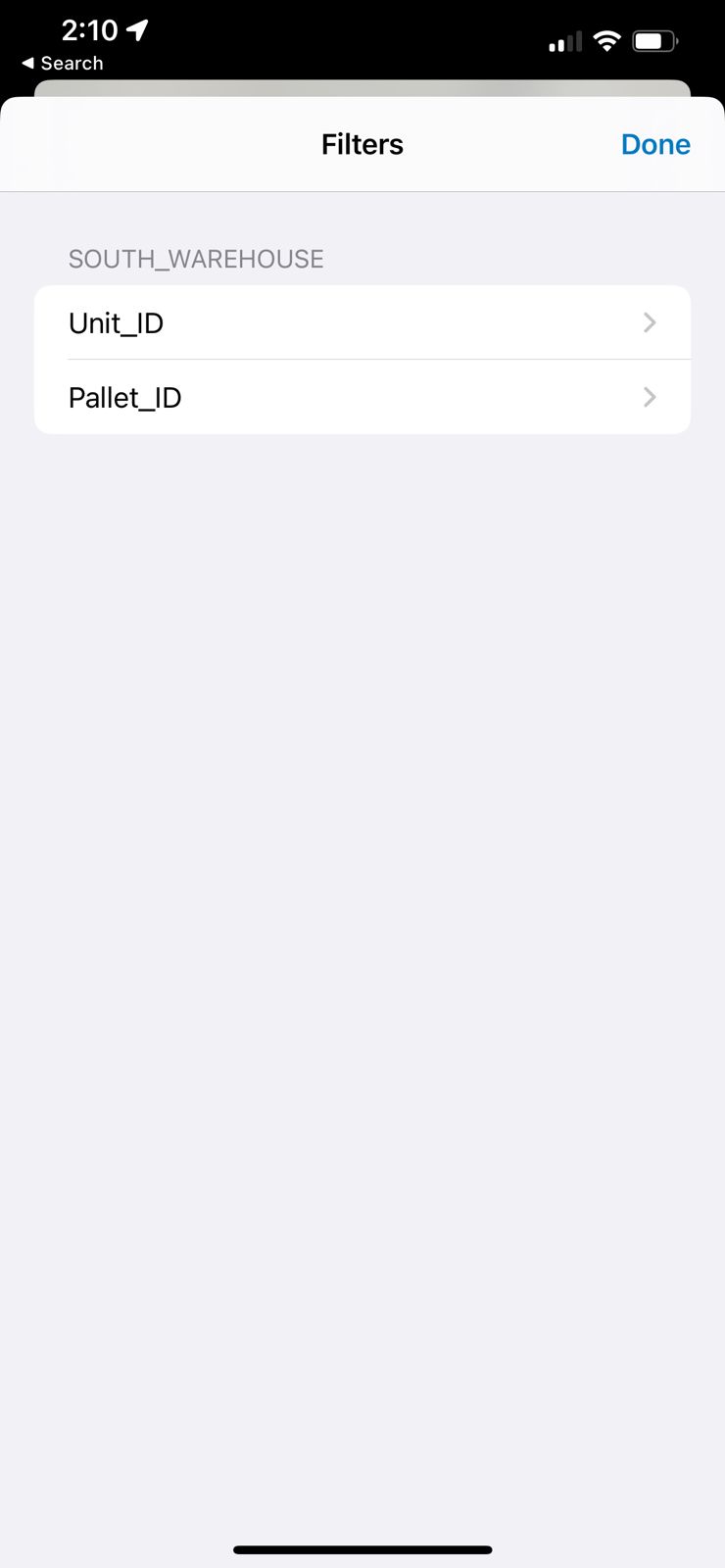

I enable the data filter with a specific field, and it just shows a limited feature that reaches 2004 points!

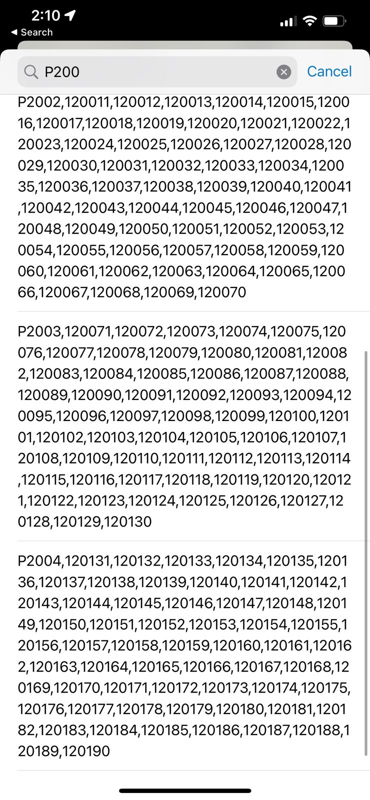

For more clarification, please note that I have 2 fields one related to the pallet and the other related to the units each pallet contains 60 units and they were checked using a specific barcode for each pallet.

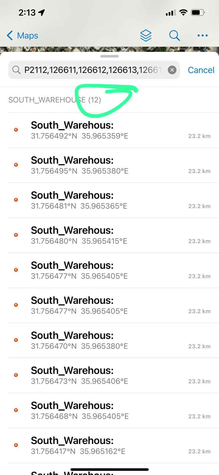

The data filter option shows the 2004 pallets not more! and when I am trying to search for the pallets using the barcode it only shows 12 units instead of 60.
