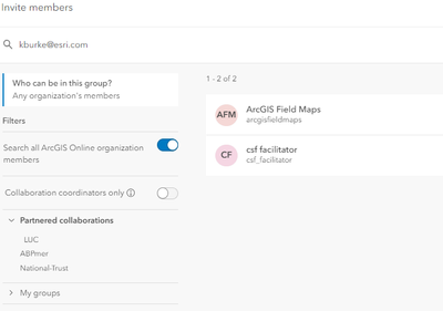

Hi @KevinBurke do either of these users relate to you:
KevinBurke
Hi @OliverIshmael
Please use the ArcGIS Field Maps user account.
Thank you
-Kevin
OliverIshmael
Thanks Kevin, I have sent you an invite.
